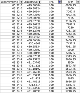

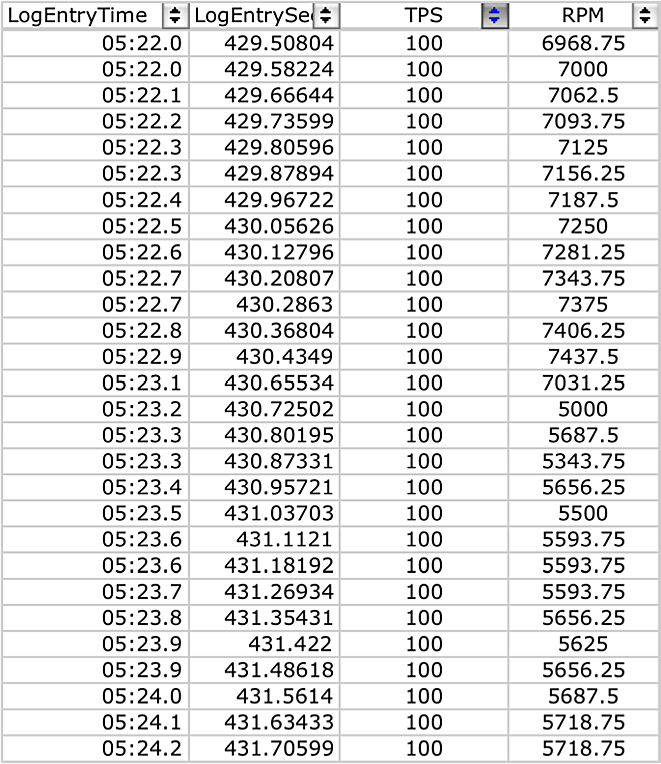

sure don't = / Ill be posting the data soon, And im not sure what has changed since then ?? I know that every time i have tracked the car that i pull a 1.7 60 ft shift well and only do a 13 flat and trap 106 - 107 so i know the car isn't running right with the mods im running = /
Old Jun 9, 2010 | 07:09 PM
rcgoff2's Avatar
Joined: Apr 2008
Posts: 150
From: Cincinnati, Ohio
please disregard this dat. The correct data can be seen down below.

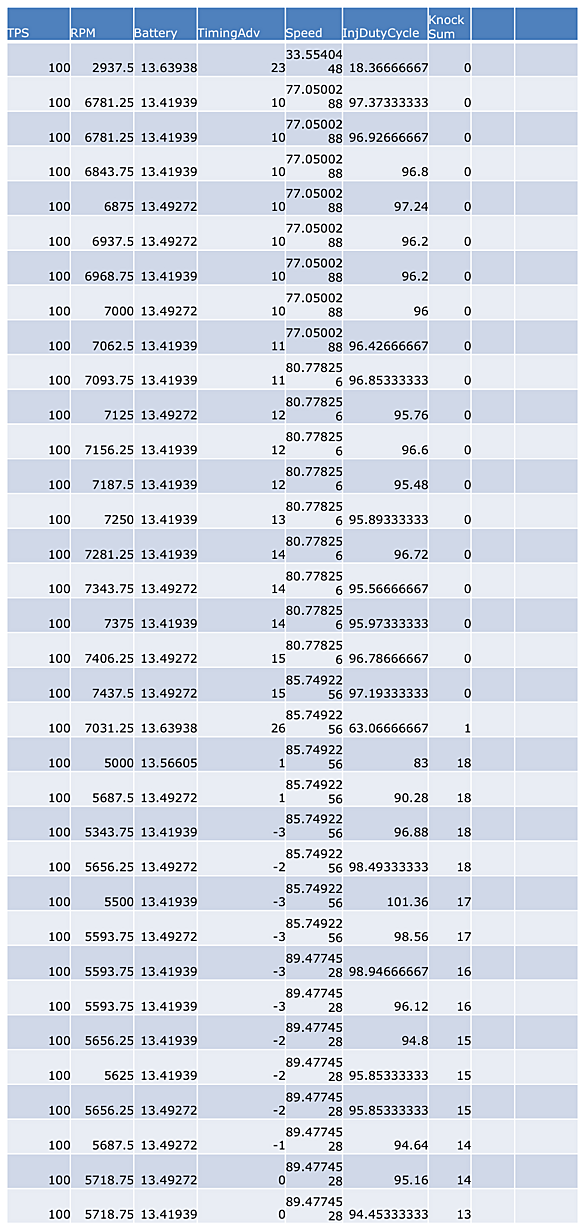

not enough info in that log..would need to see timing numbers atleast..but have u done a boost test first?
Old Jun 9, 2010 | 07:29 PM
rcgoff2's Avatar
Joined: Apr 2008
Posts: 150
dangit, i thought i had the other columns included. Sorry im a little new at posting pictures like that. Ill have the full log on shortly, and FYI i boost leak tested the car 8 months ago with no leaks.

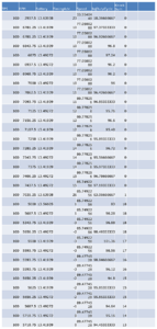

Ok here is the data from the 3rd to 4th shift. I will do a boost leak test this weekend and re log and hopefully this will solve the problem. In the mean time any help or advise would be grealy appreciated.
