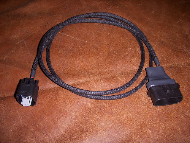

You then need to wire that sensor into your old MAF connection. You could use this pre-made wire from http://www.spoolinup.com/:
-Bink

If you're referring to going Speed Density then you'll need your intercooler pipe modified with a bungsfor the appropriate sensor. There are easy ways and harder ways to do it. There's a harness you can buy available now so it's all plug and play, no splicing etc necessary. The only real modification is welding in a bung. These guys also make a harness - http://www.spoolinup.com/ that has gotten great reviews. That and the new intake pipe and a sensor is all you need.
