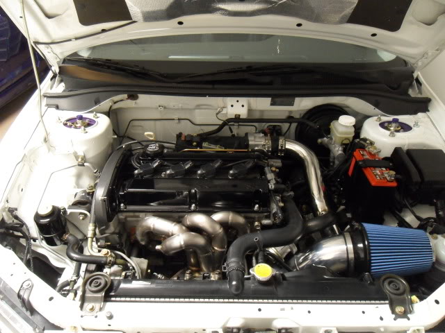

I like my intake setup, JM Fab 4" aluminum intake pipe with 4" to 3.25" reducer coupler to mate up to FP compressor cover.
