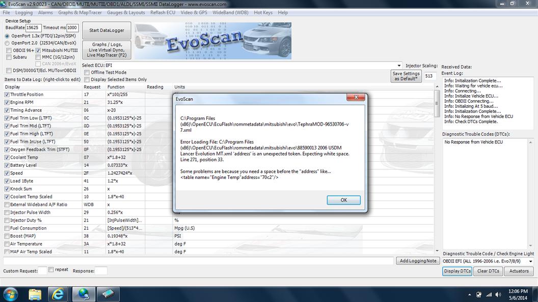

I was reading something about v2.9 and not having the correct setup in Map tracer, upon clicking on map tracer this is the error I get. Not sure if it's relatable as I'm pretty sure it said this before hand, but maybe this has some insight?
I should also mention the car is on v7 SD and I've tried both v2.7 and 2.9 evoscan as well.
