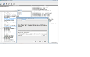

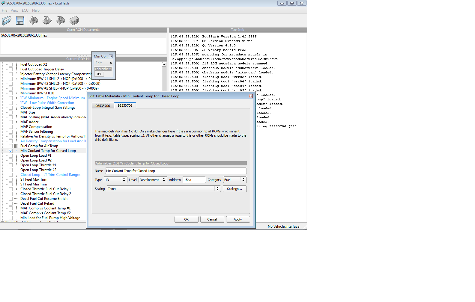

Try raising the temp in the Min Coolant Temp for Closed Loop table to 84 deg F. This will keep you in open loop a little longer and shouldn't mess with your long term fuel trims.
Attached Thumbnails Cold start issue w/ front o2 sensor-mintemp.png

I've tried that before as well went as high as 100*. But I may try it again

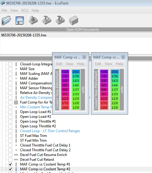

You could also try adding fuel using the MAF Comp vs Coolant Temp tables.
Attached Thumbnails Cold start issue w/ front o2 sensor-maf-comp-vs-coolant-temp.png

well i just added this to my xml, both tables have slightly different values. would you recommend having the values the same on both tables?
