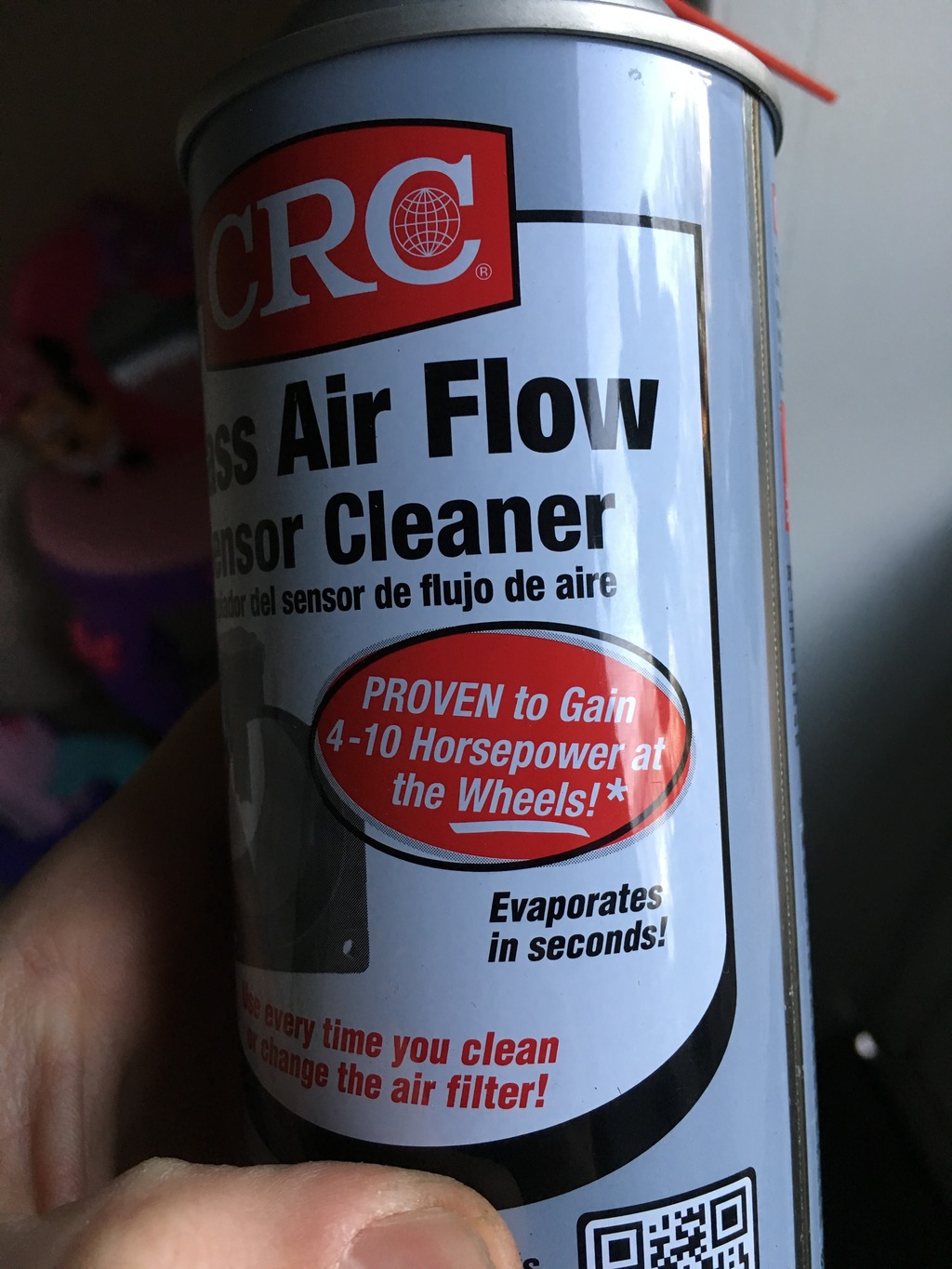

cant test untill i go to work in the morning now(wife has a meeting) fml.. but i made my everything a little richer hoping the clean maf clears up my problem
almost forgot what the bottle says.. i better tac that onto the dyno results.

Yea cleaning maf did nothing.

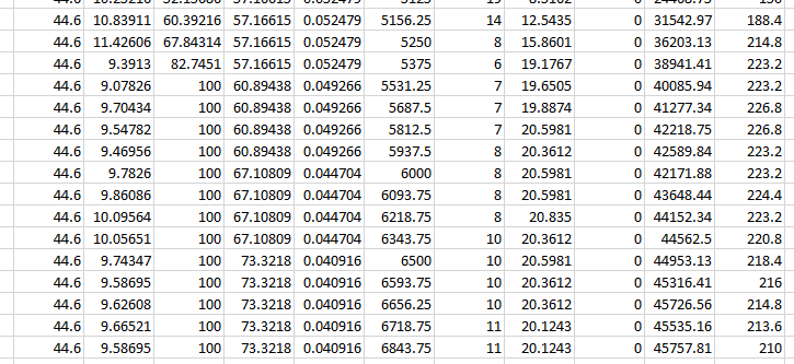

first time i ever wanted my timing to be off and no such luck. on tdc all marks line up.I said screw it and now im trying to tune it leaner with the accel enrichment so i can lower the afrs on the fuel map.
i dropped from 3000+ it was set to 1.43 so i dropped it to 1.34. made a big difference but still need to go a little lower.
below is what im at now.. im going to drop my afr #s and the accel a little more and re-log. i highlighted 220 and 6500 just to show how it differs from map to log. 12.6_12.0

Are you tuning for E85 or pump gas by the way? What target afr are you trying to hit?

93 pump trying to hit 11.3 but everytime i boost over 10psi the afrs just drop to 10 or lower. the log above was the only time it ran with numbers like that. usually they look like this from today

i changed the map about a half a point on the high end and it dropped over two and a half points.

Any particular reason you went with the BPR8ES over the BPR7ES? Is the issue just at WOT or are the Afr's wacky all through the map regardless of load?

Originally Posted by Cbr1000love
first log was my results before, just trying to hit 10.
next one is my only log with it that lean. i know the numbers are all over but i just made that map last nite and it was my first log with it. already played with map. at 6k its .6 off and at 7k its a full point off.
There are alot of parameters that go into tuning afrs right.
If merlin's guide does not make sense to you and you find yourself guessing... pay a tuner to sort it out.
