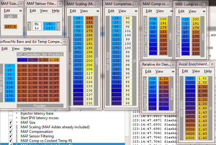

ok so my maf scaling is correct.i have no clue what a smoothing map is. the tables below(pictures) are the other maf related tables i have and it would be awsome if someone with a 399 maf could bounce off there map.
i also have the open loop maps and my accel enrichment map says incorrect on it never noticed that before
(found on a diff site)
evo 8 03
For the 399:
Sensor Filtering:
192
217
Smoothing:
115
115
123
129
128
127
128
128
127
127
126
125
125
125
124
121
121
121
121
121
121
Scaling:
145
152
165
175
182
187
191
195
198
200
203
206
208
217
222
226
233
236
237
235
232

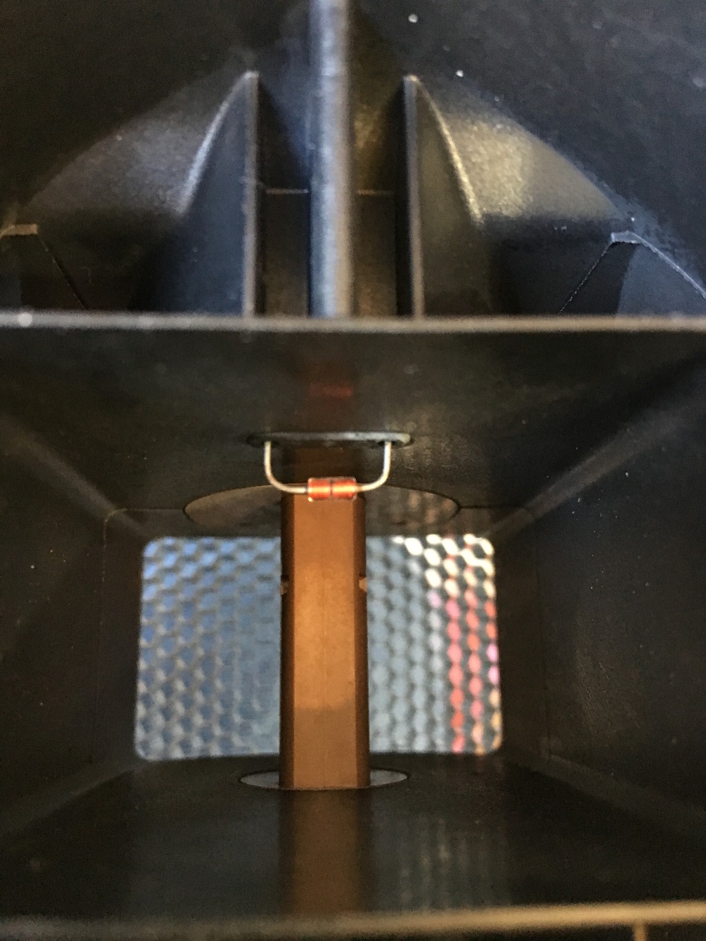

yup ill post one in a min. i found some more values in merlins tuning guide and they all match up. but i thought of something, went out and took a pic and i might of found the reason. ill find a log post it then run out to get cleaner.

quick trip to autozone.. to bad i cant test it untill the wife gets home to watch the kid.

A dirty maf will very much screw up a tune. Be prepared to retune. Also might be a good idea to check your plugs as well.
