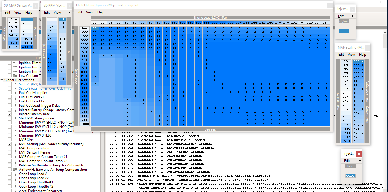

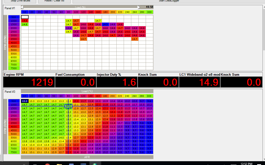

was able to snag these from the last log I left open on evoscan. Im trying to find a better way to post these up :/

By staying out of boost you likely have very little to worry about if your car starts and idles fine with no knock. The screen shots you posted above are nice, but I think what MinusPrevious was refering to was an excel sheet with parameters side by side so that we can take a look at what your engine is doing. These parameters would include, Throttle position, o2 feedback, timing, afr's (if possible), MAP values, Coolant temps, knock sum, etc. Evoscan should have a lot of these items pre-configured for you, but you'll have to change the conversion formula for the 4 bar map sensor.

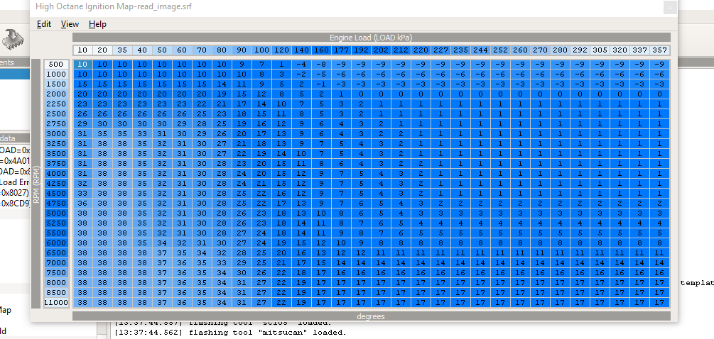

This is the main fuel and timing maps. Idk maybe its just me but they look screwy in my opinion.

Yea I gotchya biggie. Only thing that worries me is my knock light isnt flashing, and the car seems to drive ok, but Evoscan is saying im getting knock like crazy in the lower rpm range. I know its sensitive and all, and Im still a noob with evoscan and ecuflash but it looks like the guy who tuned the car last set the knock threshold pretty high so it wouldnt flash. idk. I guess im just super paranoid and dont want to hurt my baby
I mean according to my wideband I never see it really dip under the 13s which is scary. And evoscan is logging me around a constant 14.6ish with an occasional 17-19 spike. its weird.

Sorry just realized I posted timing map twice. Here's the high octane fuel map

best i could do for now. but that looks horrible..

yah i dunno WTH that block of 19.2 is about. Maybe trying real hard to save on some gas. I would just change all those back to a nice 14.7 and see how that goes. Also when you do that paste in some stock timing values in the corresponding cells in the timing map. Your fuel trims are pretty bad, but try fixing those fueling values first wipe the trims by pulling the battery and see how it does.

That block of 19.2 only gets used on start up, when the car is in open loop. Otherwise the car should always be in closed loop at idle. Having to pull that much fuel their points to a not very good base map.

Yea, thats the "tune" that was on the car and I cant wrap my head around it lol. And evoscan is showing that Im stupid lean and getting knock. ughhh
