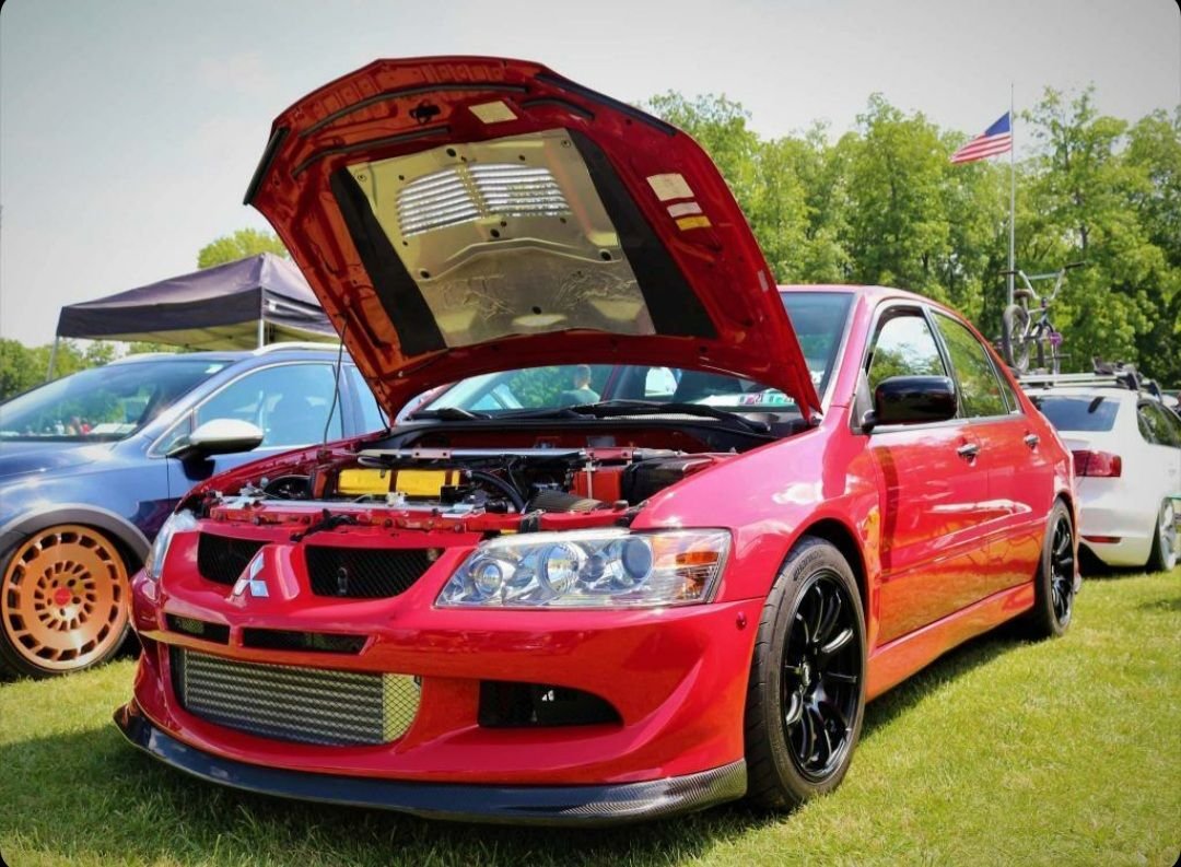

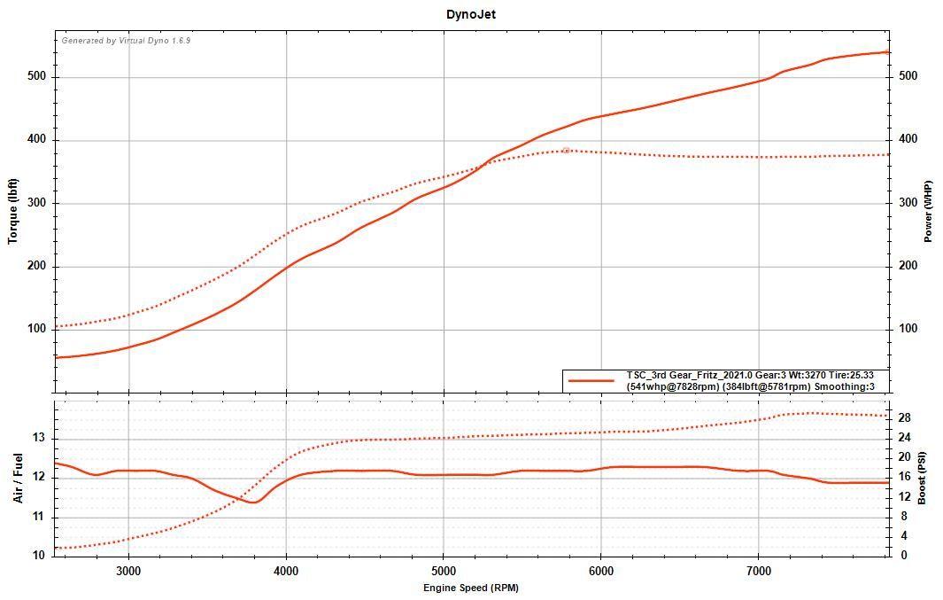

2004 Evo 8 RS UHF Green, stock 2 liter, flex fuel
I was street tuned by TSC about a month ago with this turbo and I'm pretty happy with it on my stock 2 liter Evo 8. It has:
FP UHF Green (Xona bb chra, ss housing)
FIC 1650s
Twin 255s
Stock Ecu flex fuel and speed density
3 port ebcs
JMF IC and piping (lower/short upper)
Tial Q BOV
STM DP with VTA 38mm WG
Test pipe and STM stainless exhaust
GSC S2 cams/springs/retainers
Curt Brown ported intake mani and
S90 70mm TB
Kigley HLA
ARP L19 head studs
STM bellmouth intake
FP cast exhaust manifold
This pull was reading around 72% ethanol, temp was around 82 degrees and was a pretty smooth seemingly flat section of highway. It's just a VD graph for now so take that for what it's worth. Still looked pretty nice with smoothing 2. Boost takes a brief ramp up to about 28-29 psi above 7k. Started the pull around 2500 as you see, and hit 20 psi right around 3900-4k rpm. Not bad for an SS housing I suppose?

Well done, thanks for sharing your results. Nice flat torque curve once it’s on song.

I though it was the least I could do! I figure there's a few anxious people left that still have interest in these turbos and may have a very similar setup to mine. I will set up a dyno jet session at a local shop to see what it makes there for comparisons' sake. Stay tuned.

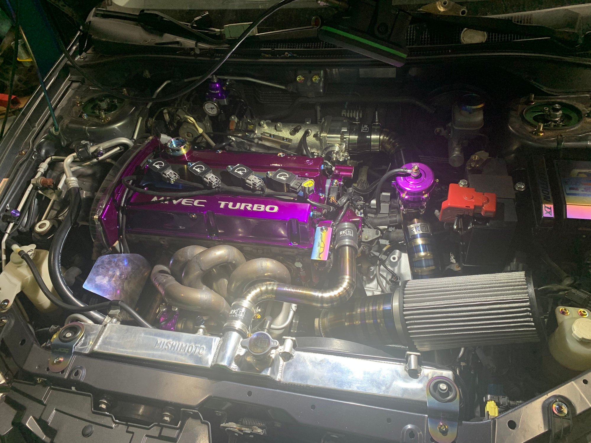

Will do, currently waiting for a slot to pull my car in. I’m optimistic for next week. Here’s a pic of the engine as we finish up the build.
