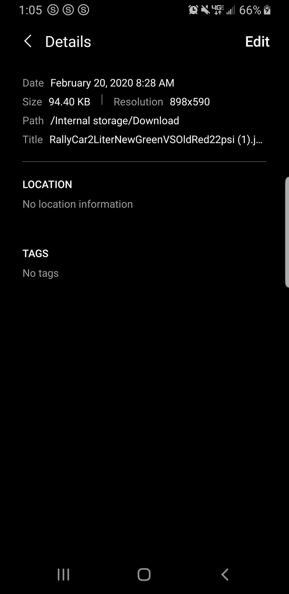

They have a dyno chart on their site. In theory, it will be the laggiest Green they offer. The trade-off is less back pressure up top, so it will make more power at same boosts. Here is their comparison with old Red at 22psi boost where it spools a bit faster (since Green is a smaller turbo) and makes more power up top (since less back pressure). I think this is on pump gas, so turbo has a lot left if running E85. But if you want a 4,000 rpm punch, I don't see that happening with this turbo. I expect 400-700 rpm delay (from your target) on this UHF turbo.
I think you are reading it wrong.
Per FP: "One is the current FP Green UHF, the other is the same FP Green UHF laid on top of last years combination with a FPRed model. Your first thought might be "holdup, that new Green spools up the same as that Red and doesn't make the same peak power". Well, last season the engine was a built long rod 2.4 with 10.5:1 CR and that dyno graph is 22psi. This season the engine is a stock 2.0 bottom end and the turbo comes on so fast that we are actually having to open the gate early to keep the torque below the failure level on the stock connecting rods! So we have almost the same power and response this year with a stock engine and FPGreenUHF turbo as we did last year with a built long rod 2.4 with 10.5CR and a bigger turbocharger."
So the dashed line would be the 2.4LR 10.5cr with FP Red and the solid line is the stock 2.0 with UHF Green. But FP doesn't mention the psi on the UHF Green pull or if the FP Red was mhi or ss housing.
I don't think it doesn't matters. Both curves show slow spool. Lol. I figured one was Red and other was new Green UHF from title of file. I still expect this UHF Green to wake up between 4400 and 4700 rpm on a 2.0.
Per FP: "One is the current FP Green UHF, the other is the same FP Green UHF laid on top of last years combination with a FPRed model. Your first thought might be"holdup, that new Green spools up the same as that Red and doesn't make the same peak power". Well, last season the engine was a built long rod 2.4 with 10.5:1 CR and that dyno graph is 22psi. This season the engine is a stock 2.0 bottom end and the turbo comes on so fast that we are actually having to open the gate early to keep the torque below the failure level on the stock connecting rods! So we have almost the same power and response this year with a stock engine and FPGreenUHF turbo as we did last year with a built long rod 2.4 with 10.5CR and a bigger turbocharger."
They may be saying that. But it makes 280wtq at 4500. That is so far beyond safe for the stock rods it's silly. Stock turbo cars make 380-400wtq at 3600rpm. That graph is a terrible comparison, two very different engines and two very different turbochargers, and then a "reason" for as to why the UHF green basically appears to suck. I would not base my purchase off of any of that info.
My MHI red made 400wtq at 4500 with the stock 2.0L, S2's, and no mivec...
