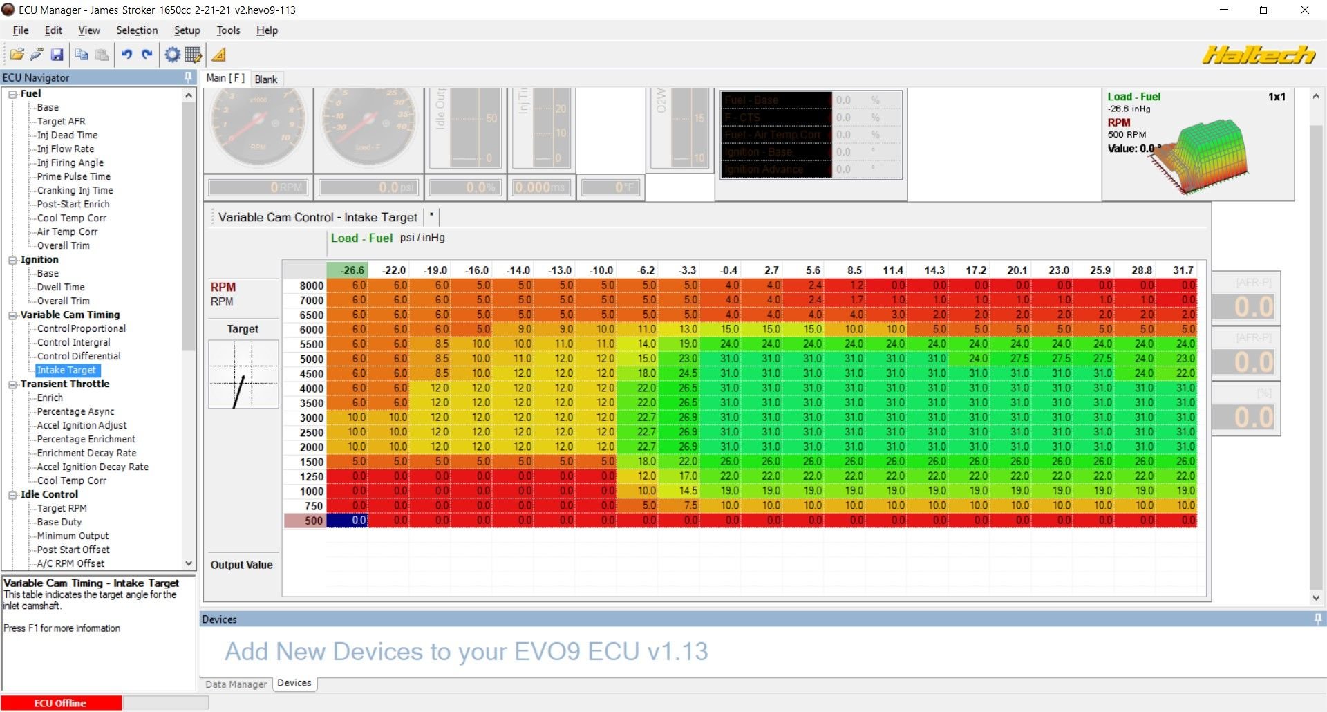

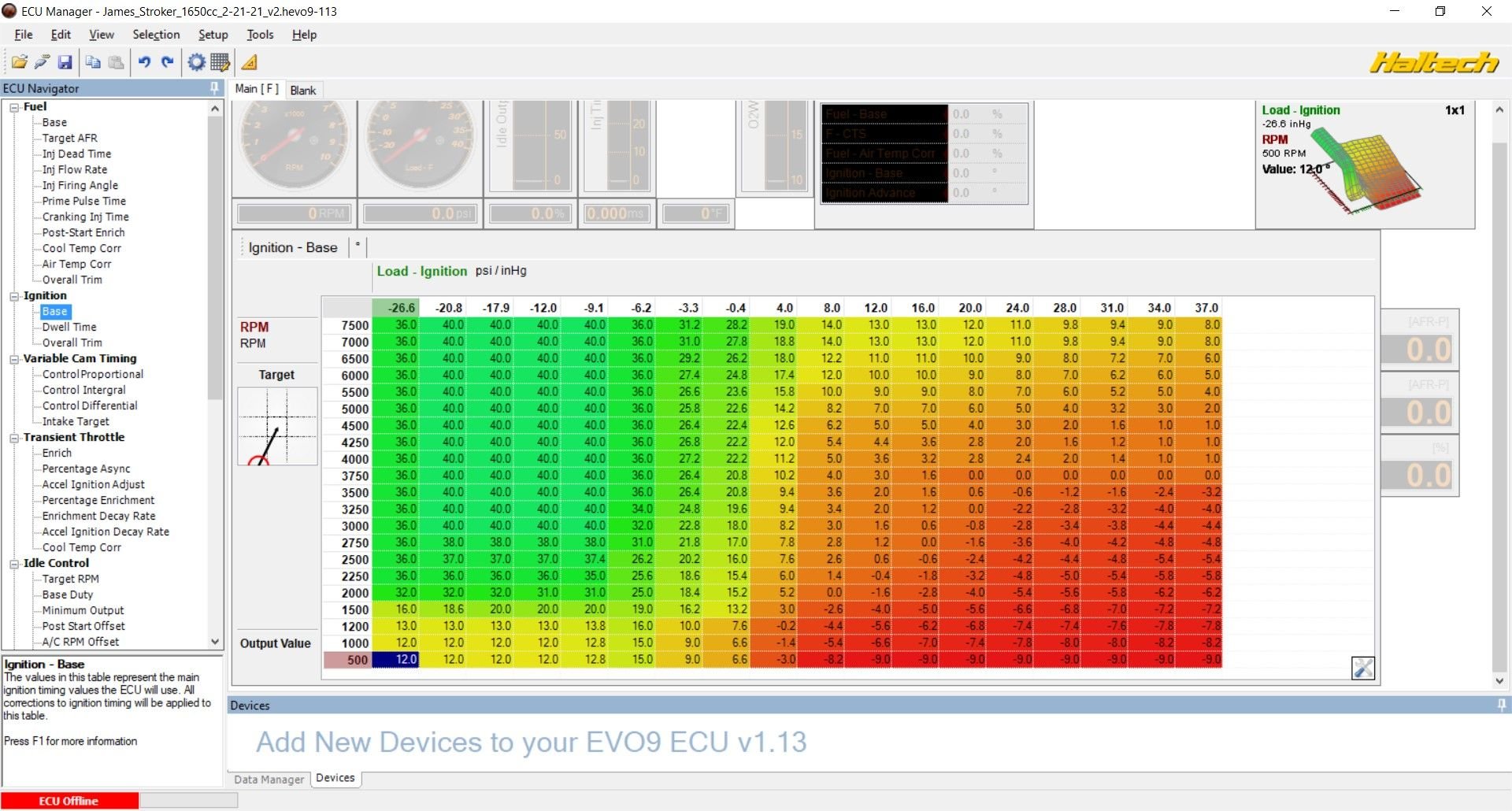

Post a screen shot of your Main setup page in Haltech. Trigger angle will be 76deg. Below are some base maps, but they need to be tuned specific to your setup.
