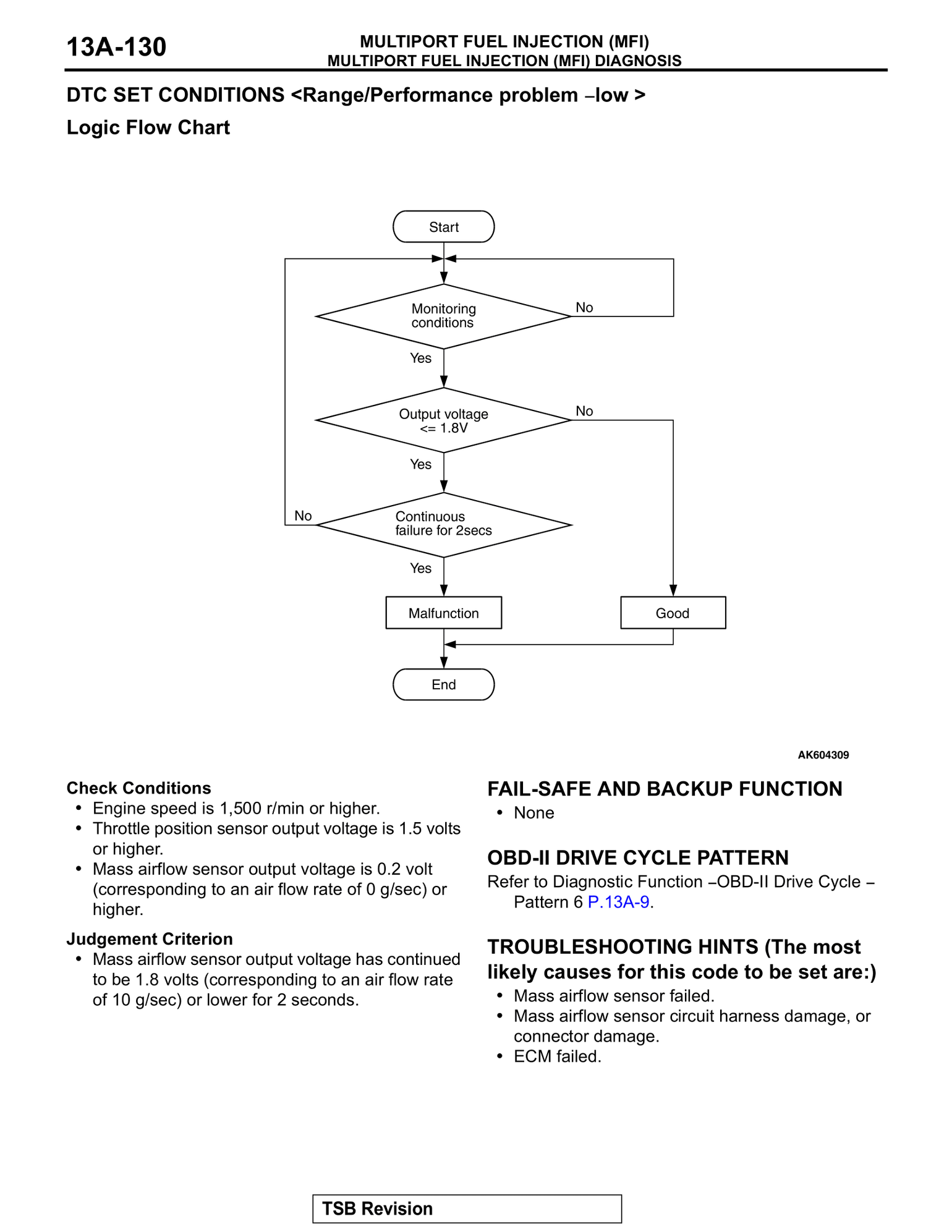

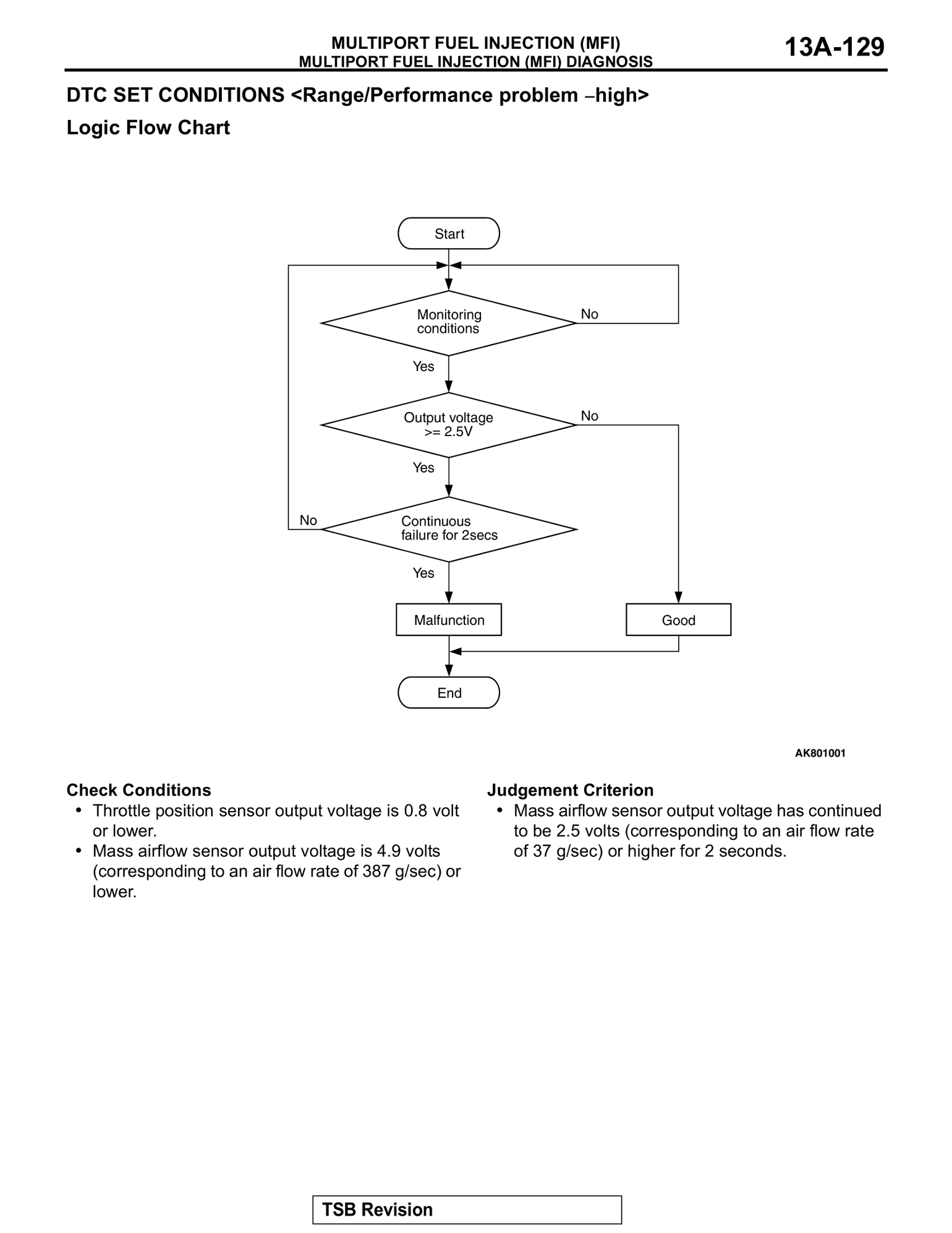

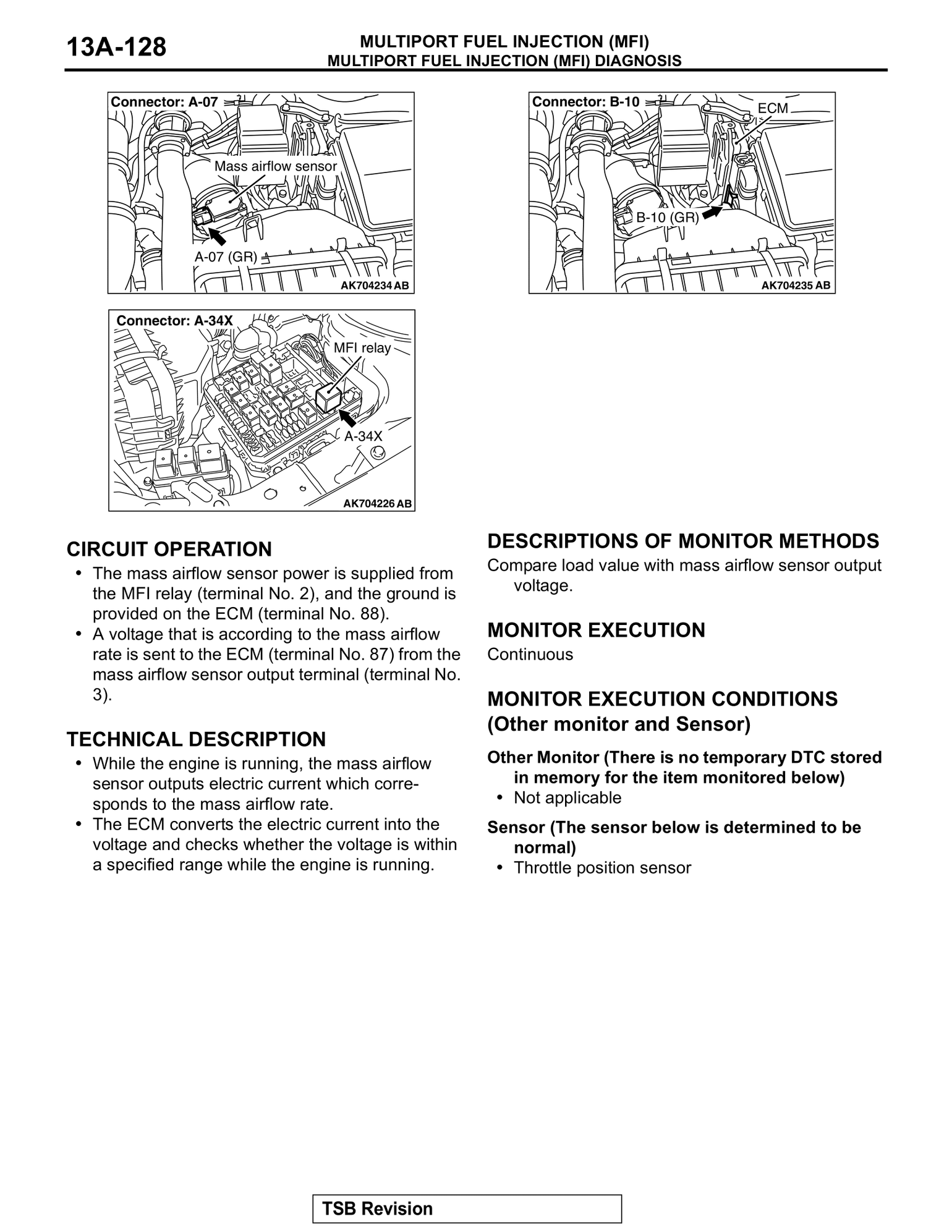

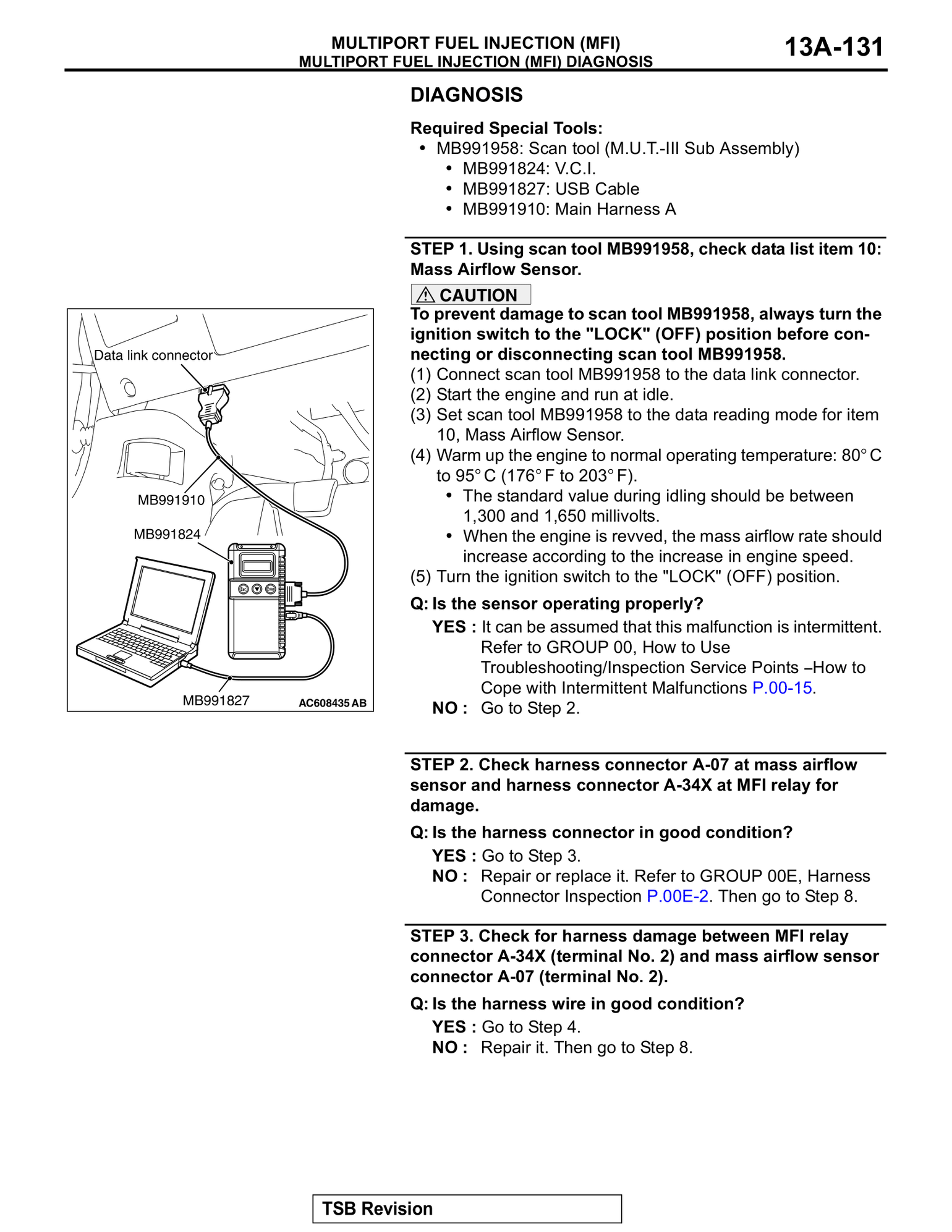

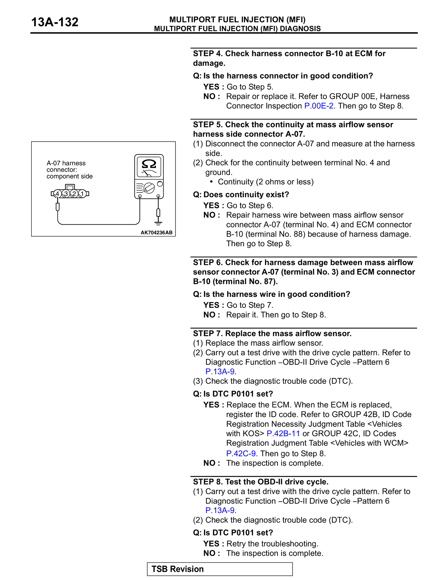

I pulled this from the service manual. I hope it contains the info you are looking for.

Hm. So they changed to a 0-5v straight voltage sensor.
I wonder why?
Thanks.

There are several reasons>
1. It is easier to manufacture a hot wire (Evo X) MAF vs. the Karman vortex MAF (Evo 8/9), so lower cost and Mitsu make more profit.
2. A hot wire MAF has more linear operating characteristics than a Karman MAF which means that low speed operation and engine idle have better fuel calibration (= lower hydrocarbon emissions) and you have a smoother driving experience.
3. The hot wire MAF has less cross sectional area, therefore less restriction to air flow into the engine, which means more potential power.
