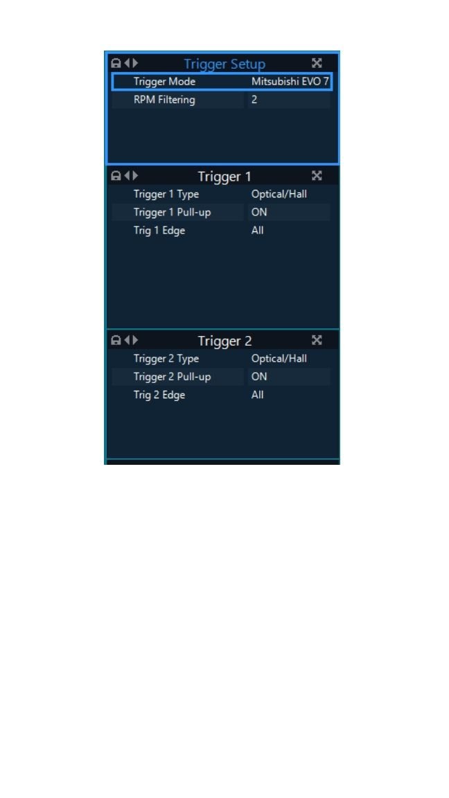

Hi Guys,
I'm really at my wit's end already hence trying to ask for some advice from experts regarding my currrent issue.
Engine is freshly built full Manley 2.2L 4G63, with brand new trigger plate, crank sensor, and exhaust cam sensors.
Running Link G4X Fury with custom wire in harness, I'm facing with trigger 1 errors, definitely not crank walked, I've tried every single possibilities including turning up trigger filtering, adding grounds to ignition coils, etc.
Trigger error only happens under acceleration and in boost, I'll attach a link to the tune and a datalog of the trigger error happening since evolutionforum doesn't allow uploading of pclx files.
https://drive.google.com/drive/folde...usp=drive_link
Trigger setup is uploaded, wondering if trigger edge 1 / 2 on ALL would be a problem?
Thank you in advance
Trigger setup
Trigger setup
