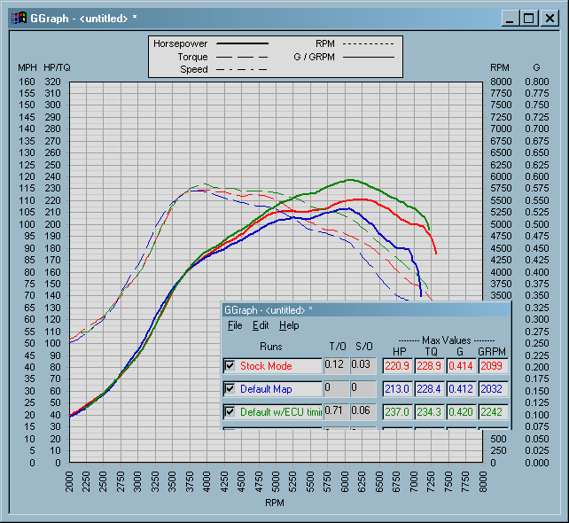

OK, here goes. I recently installed some exhaust components, and was somewhat disappointed in the overall performance. Well it turns out that the default timing map just completely SUCKS. I mean it runs much less timing than the stock ECU, like 1/2 the timing in some places. But FINALLY I'm happy with everything, using the default map with all the timing values set to ECU. When running through the gears, I get some knock events around 6500 RPM, and also just above 7000 but only when I let off the gas. I don't think the ECU is detecting knock when this happens but I'm not sure yet. Now here's a situation where it would be REALLY NICE if the UTEC let me enter timing values relative to the ECU's values, instead of absolute ones, so I could take out a couple of degrees in the problem areas. For these 3rd gear runs, there was no knock though, so I suspect I'm getting actual knock when going through the gears instead of just picking up some noise (more heat and all).
(EDIT: Looking at the 3rd graph, the ECU actually did pull a small bit of timing at 6523 RPM. If only I could pull a bit of timing myself in that area like an XEDE user...)
SO ANYWAY, here are 3 runs, along with G-tech graphs that were recorded along with them. I did a run in stock mode, then a run with the default TXS map, then a run with my map which is currently the default TXS map with ECU timing. Note in the G-tech graphs (and the ones that Jack will hopefully make from these logs for comparison), that running the UTEC in stock mode is actually BETTER than running with their default map. Maybe with crappy gas that wouldn't be the case?
Temperature: 71F
Humidity: 75%
Altitude: somewhere around 3000 feet.
Mods: Buschur 2.5" downpipe, AMS 3" catback, boost restrictor pill removed.
93 octane.
My boost hits 1.58 hkPa (22.9 PSI) and falls to around 1.44 (20.9) at redline.

For those not familiar with these logs, the 4th column from the right (+16.2 in the 1st row) is the timing specified in the TXS default map, which was the value used in this run. The 6th column from the right (with +17.1 in the 1st row) is the timing that the ECU would have run at this point, if the UTEC wasn't there. By comparing those two columns, you can see why the car actually performs WORSE with the UTEC if only using the default map without any tuning. The UTEC is increasing boost and decreasing fuel a bit on the top end, but it's not enough to compensate for the lower timing values.
Also note that when my car was otherwise stock except for the UTEC (stock exhaust), the performance with the UTEC default map and stock mode was almost identical (in other words, the UTEC didn't really do anything for me). But with these exhaust mods, it ran noticably better in stock mode.
Again, this is all due to the poor default timing map, not the UTEC itself. Obviously things would be much better after creating an optimal map on a dyno, but I like to complain about the fact that the default UTEC map isn't usable as-is, unless of course your Evo is too fast, and you want it toned down a bit.

Old Jun 9, 2004 | 10:39 PM
BigBoogieman's Avatar
Posts: 265
From: SW PA
...And finally, the G-tech HP & torque graphs that correspond to those logs.

Old Jun 10, 2004 | 09:22 AM
DataLogLab's Avatar
Posts: 16
From: UK
Hi BigBoogieman.
First of all I need you to check the two car definitions linked below, say which is the closest to your car, and what changes need to be made to make it spot on, particularly weight and wheel/tyre size.
5-Speed:
http://www.dataloglab.com/images/EVO85-SpeedCarDef.gif
6-Speed:
http://www.dataloglab.com/images/EVO86-SpeedCarDef.gif
Thanks,
Glenn
Data Log Lab Support
www.dataloglab.com
Old Jun 10, 2004 | 06:20 PM
Posts: 265
From: SW PA
It's the 5-speed. The weight should be close, but I'd knock off maybe 80 lbs if that much matters. Tire size is 245/40 on 17x9 wheels.
Old Jun 11, 2004 | 01:30 PM
DataLogLab's Avatar
Posts: 16
From: UK
Here you go:
Data log 1 (stock settings) graphed with some other data log items:
http://www.dataloglab.com/images/tem...an1_Sample.gif
and as a separate Power Graph
http://www.dataloglab.com/images/tem...man1_Power.gif
Data log 2 (UTEC defaults) graphed with some other data log items:
http://www.dataloglab.com/images/tem...an2_Sample.gif
and as a separate Power Graph benchmarked against data log 1:
http://www.dataloglab.com/images/tem...man2_Power.gif
Data log 3 (Stock timing) graphed with some other data items:
http://www.dataloglab.com/images/tem...an3_Sample.gif
http://www.dataloglab.com/images/tem...man3_Power.gif
This last one shows some useful improvements over stock. Because the UTEC data logging frequency is only 5Hz, I'd recommend performing power runs in 4th gear to get better resolution (speed limits permitting!).
Glenn
www.dataloglab.com
