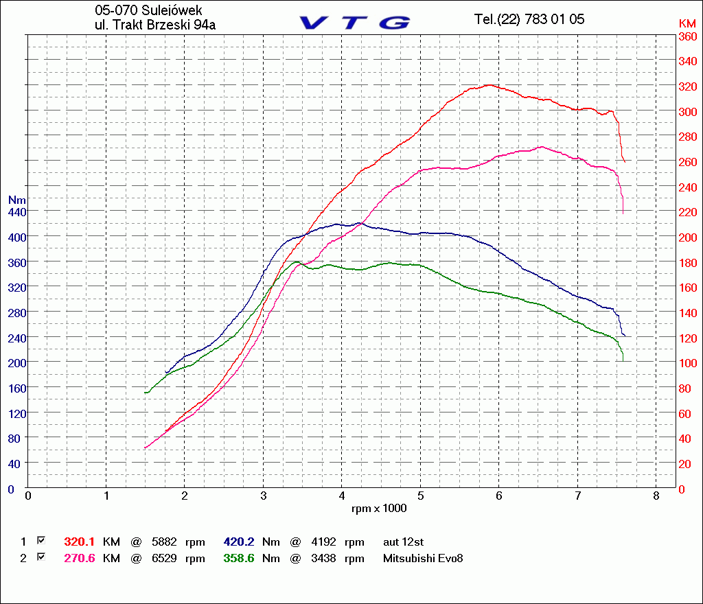

Hi Guys!
Here you have dyno results for Evo 8
Mods are:
HKS Super Mega Flow Kit (Intake) - without air box yet
HKS Hi-Power Exhaust
HKS Down Pipe
HKS SSQV Blowoff Valve
Autronic P&P ECU for Evo 8
The goals were to made as much of Torque as possible and to make results safe - the car will have a lot of millage in the future.
All comments about the results are welcome!

we need a conversion from N.m to ft.lb

Of course smaller result is from stock - without mods at all. I believe that metric units will not big problem for you
For lazy ones:
270KM = 267hp (not whp!)
320KM = 315hp
358Nm = 264lb/ft
420Nm = 310lb/ft

Where is your timing set between 5,500 and 7,000 rpm? Also how much boost, what a/f ratio, and what's the octane of the fuel used? It's hard to comment on dyno numbers with just a list of bolt-on mods.
