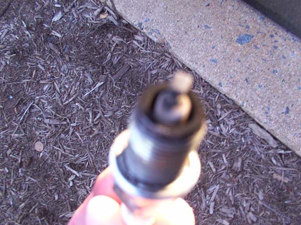

just to be safe check your spark plugs.. that should tell you whether there is knock.

http://www.atlanticjetsports.com/_techtalk/00000005.htm
THis isnt the best website, but it says at the bottom that
"A detonation problem would show signs, such as silver specs, black specs, or melting or breakage at the firing tip."
So i would look for anything like that.

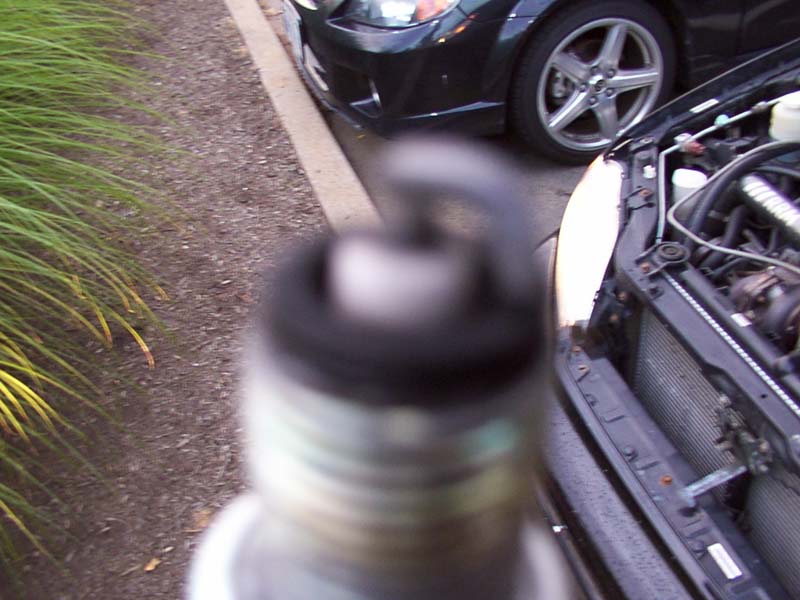

Here is a picture of my spark plug (passenger side one). The pictures suck *** because my camera sucks at pictures up close. I'll go back out and look for silver or black specks. The plugs look fine though. Lean would make them whiter right? While rich would make them carbon covered?
EDIT: Looking at the website, there is no way I am running lean. The electrode is still fine and it's copper and has 8000 boosted miles on it.

As far as i can see they don't look bad..

well, not that this has anything to do what's going on, but refer to the first picture you posted, where is your cooling fan at?
LOL. Damn, someone spotted it. Vince didn't provide me with the fan. I don't run AC and keep a keen eye on my water temps via an Autometer gauge, so I'm in no danger of overheating. I'll get one eventually. My roommates Mazdaspeed Protege is in the background too.
