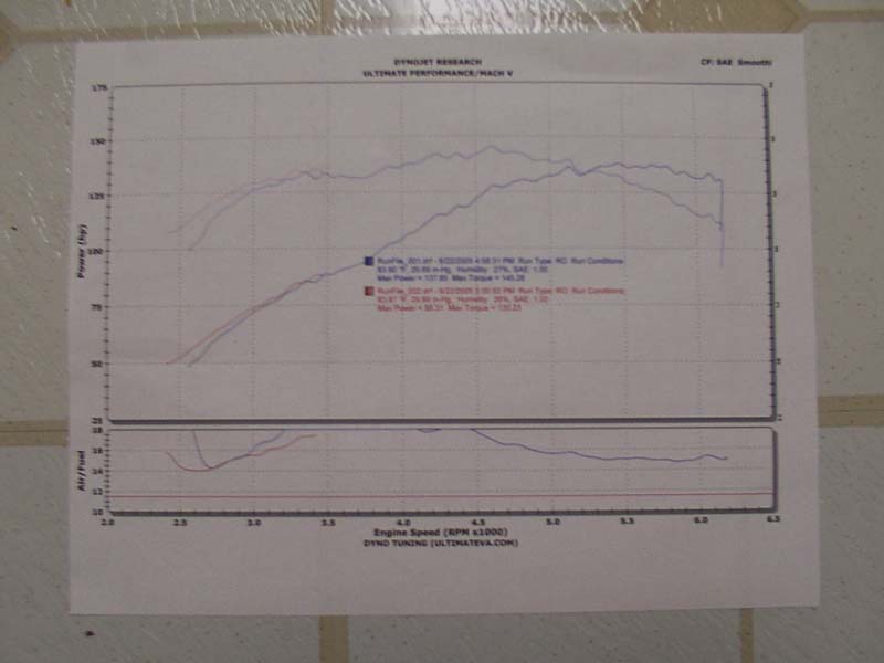

I have an RRM stage 1 setup that I bought used off of Vince (Guru_Del) with 15000 miles on it. I have put 8000 on it and finally got around to getting on the dyno. My results were pretty scary to be honest. My scanner is down too, so I can't scan, but I'll take a picture and post. Andy they only did one pull because they were nervous about it, and they still charged me the full price $120. Here's the synopsis
2700 RPM - 14.7 A/F
3000 RPM - 16.0 A/F
3200 RPM - off the chart (>18.0) A/F
4200 RPM - 17.75 A/F
4350 RPM - off the chart (>18.0) A/F
4500 RPM - 17.75 A/F
5000 RPM - 15.5 A/F
6000 RPM - 14.7 A/F
So, wtf is wrong with my setup? I'm guessing this is why my engine is sounding so funny, all kinds of ticking under the hood. Is the FMU adjustable? Could the FMU be bad? Could my ECU be messed up?

Oh, maxed out 137hp and 145ft/lbs @4500 RPMs
Yeah, idk either. Wish I had a wideband right now so I could double check the readings.

Well, if Auterra weren't a bunch of douchebags and sent me the right software I could double check it with a laptop dyno-pull, but they sent me the PDA software and not the Windows software. A$$hats.
Here's the Dynojet print out:

...obviously you're not getting fuel at load...u need to be very careful...get yourself a wideband af gauge...and make sure your injectors are not clogged or something...i think u need to upgrade your injectors...how much fuel are you running?

no, if anything CEL will richen you up. My guess is the WBO2 they're using is fouled. You need to find another shop or just start doing this yourself. $120 is 40% of a Zeitronix with O2 bung 2-day shipped to you. And you could have been making runs all night with the Z.
Shouldn't the Stg 1 be pretty much plug-n-play? I would have expected a little lean: 12.5 or so, but your numbers aren't supported because you managed to drive your car home.
