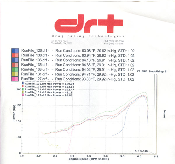

looks like the problem is solved. the stock injectors simply can't take the extra boost on the fuel lines, so they spew everything they got at WOT, making me run super rich.
they slapped in some good 340cc injectors and its running like it should, no problems at all.
car should be back in my hands this weekend
here is the dyno just to show how screwed up it was before. remember, even on the good runs, my a/f was in the 8.0's. but if i got near 200hp with the crappy setup, now thats its fixed, 220hp seems doable:
Attached Thumbnails Project:  Auto RIPP SDS-rippauto.jpg
