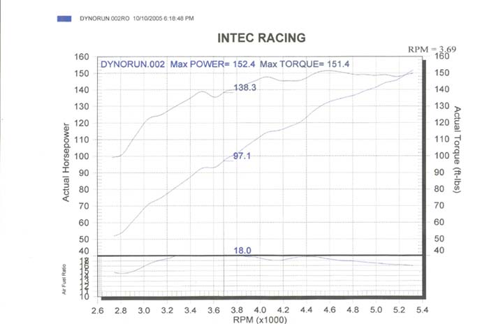

Well, assuming FMU's normally do provide acceptable AFR ranges (and I can only assume they do because I don't remember anyone who runs an FMU setup mentioning WBO2 readings), they were probably right. Either the FMU, fuel pump or both are crappin' out. Is this only happening at 5psi or does the AFR gradually raise building up to it? like 15.0 at 4psi or is it normally rich then shooting up? Is there noticable knock? Are you certain the WBO2 was calibrated correctly? Tryin' to think of variables to rule out, but I'm also writing a lot of papers all week so my brain's kinda in left field....
Here is my dynosheet.
The guy said it starts to lean out once it's boosted and I'm pretty sure their o2 sensor was working properly.

yeah there O2 is working correct....cause the numbers show that he is running lean. ill talk to u tommorw and hopefully get **** sorted out....with my hrs on the phone to Rock and trip to RRM....my hrs of dyno time and testing everything....i should be able to help...why am i not a guru....LOL

Yeah, that's exactly what happens on my car. If I had to guess I'd say it's the fuel pump. Guess we'll find out soon enough.

Originally Posted by grubiaco
lancerguy what was the problem with your setup?
He had a bad fuel pump and it was causing him to run lean. Probably that's my issue, I'll find out tonight.

Walbro 255. Not certain mine's the issue, but it still seems that way to me. It's fine until she starts building load. Positive boost pressure = problems.

fuel pump problems aren't that uncommon, especially walboros, they can be bad, id buy a new walboro 255 stick it in and see what happens, even though he is running a tre
