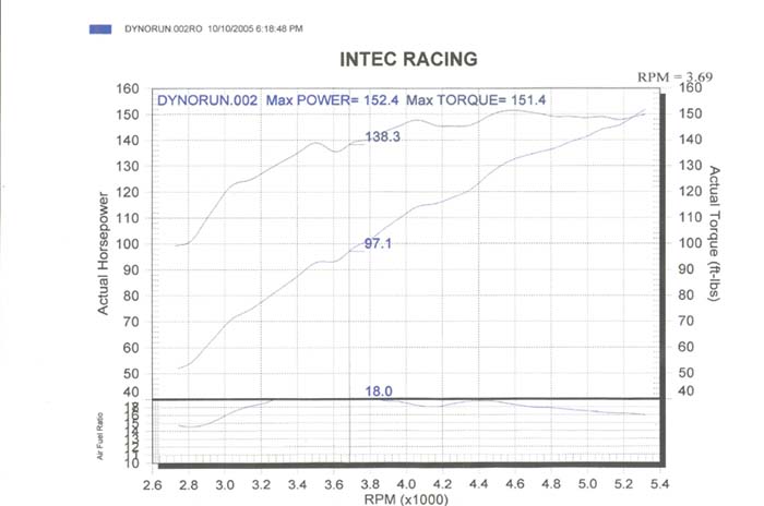

I went to a dyno shop today and had my first run. It pushed 152.4whp and 151.4 wtq @5psi and it's running super lean (18.0 a/f ratio)
The guy over there told me that my fmu might not be working right and probably my fuel pump also, so I'll check those tomorrow. So I'm not going to be boosting until it's fixed.
You guys have any idea why it's running super lean?

First off which FMU disk are you using? Any and all fuel system info would help.
Using Blox 12:1 FMU and TRE 255lhp fuel pump.
Well, assuming FMU's normally do provide acceptable AFR ranges (and I can only assume they do because I don't remember anyone who runs an FMU setup mentioning WBO2 readings), they were probably right. Either the FMU, fuel pump or both are crappin' out. Is this only happening at 5psi or does the AFR gradually raise building up to it? like 15.0 at 4psi or is it normally rich then shooting up? Is there noticable knock? Are you certain the WBO2 was calibrated correctly? Tryin' to think of variables to rule out, but I'm also writing a lot of papers all week so my brain's kinda in left field....

Any exhaust leak will register leaner than normal AFR's, b/c of oxygen getting into the exhaust..
