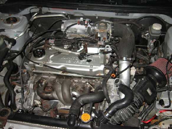

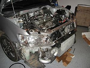

Hey, im working on my 16g turbo for my Oz lancer. Just wanted to post to show my progress and add another (hopefully) successful install. Right now i have the exhaust manifold completed, tubo sitting in place, oil supply ran, slim fan installed, walbro installed, forge adjustable wastegate actuator ready to be popped in (putting in last because i left radiator in). I have lots of pictures, and a list of everything i have done so far that i will hopefully have time to post. Thanks alot to the members who have previously done this for answering a couple of my questions, and to this site who without makes stuff like this much harder.
If anyone is wanting to do this setup, and you have access to a CNC plasma cutter, i drew up a CAD .dxf file that can be used for the 4g94 flange. It is going to need to be drilled and the ports will need to be opened up, but it worked quite well for me because i got the flange free this way. Just get them to cut it out of 3/8 stainless.

oh just asking cause it seems like you relocated the battery, unless you just took it out and are putting it back in it's place.
Old Jan 10, 2007 | 08:22 AM
0zlancer's Avatar
Joined: May 2006
Posts: 164
From: Daytona Beach, FL
Yeah i just took it out and will be putting it back in later. I dont want any electricity running through it while im working on it. Weren't you going to go turbo Wallesasuaz?

I love the idea of using the Evo's parts on other cars. Nice use of the IC and piping. In fact, I have an Evo IC and piping I'll be using on a D-series Civic motor. If it'll hold near 300+hp stock, it'll definitely hold the 350 I'm aiming on the Civic...

I am using the Forge Adjustable wastegate, and asked them to change the spring out to a 7lb. spring. I absolutely love this setup, IC and piping basically lines up perfectly. The way i see it is that it would almost be foolish not to.

where did u get that manifold?

That manifold Looks totally custom ...
