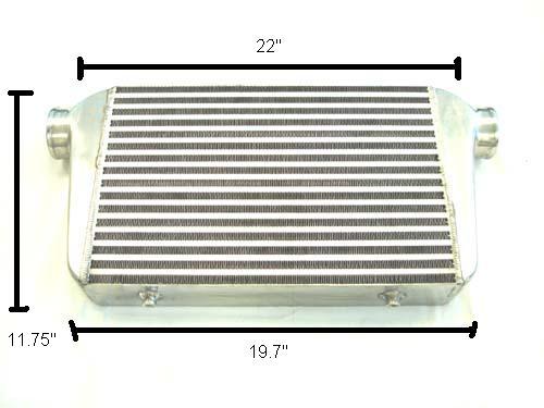

For those interested in my custom turbo this is what I have purchased so far, it will be installed hopefully this upcoming summer maybe sooner:
Have:
-Mitsubishi evo 3 big 16g tdh05 turbo
-Megan racing small intercooler (some mods wil need to be done to install it)
-Greddy BOV
-Tial wastegate
-Greddy emanage ultimate
-Custom intercooler piping
-Various tubes, lines, gaskets and wires for install
-Megan racing gauges version 1 (all of them except water temp)
-RC fuel injectors 370cc
-oil lines and components

Okay sounds good and yea it was your posting I was reading its very interesting opens up a lot of possibilities. Im not looking to be a hero and get impressive gains (400+) by turboing. I will probably be looking to get around 280whp (hopefully if I can find a way to keep the cvt in check). Its just something to compete with RRM maybe. Seeing if the tech savvy lancer owner can throw together a reliable and producible turbo kit on a budget, maybe create a generalized guide to this and compile some turbo options for the 4b12. The reason im curious about internals or upgrading parts to perform better is to see what "potentially" the 4b12 has to offer. Of course at a price lol not looking to spend 10k to supe up my 4b12, looking for cost effective, reliable and budgeted.
scumrat ill keep you posted if i cant get the megan racing one to fit ill most likely resort to the evo 9.
