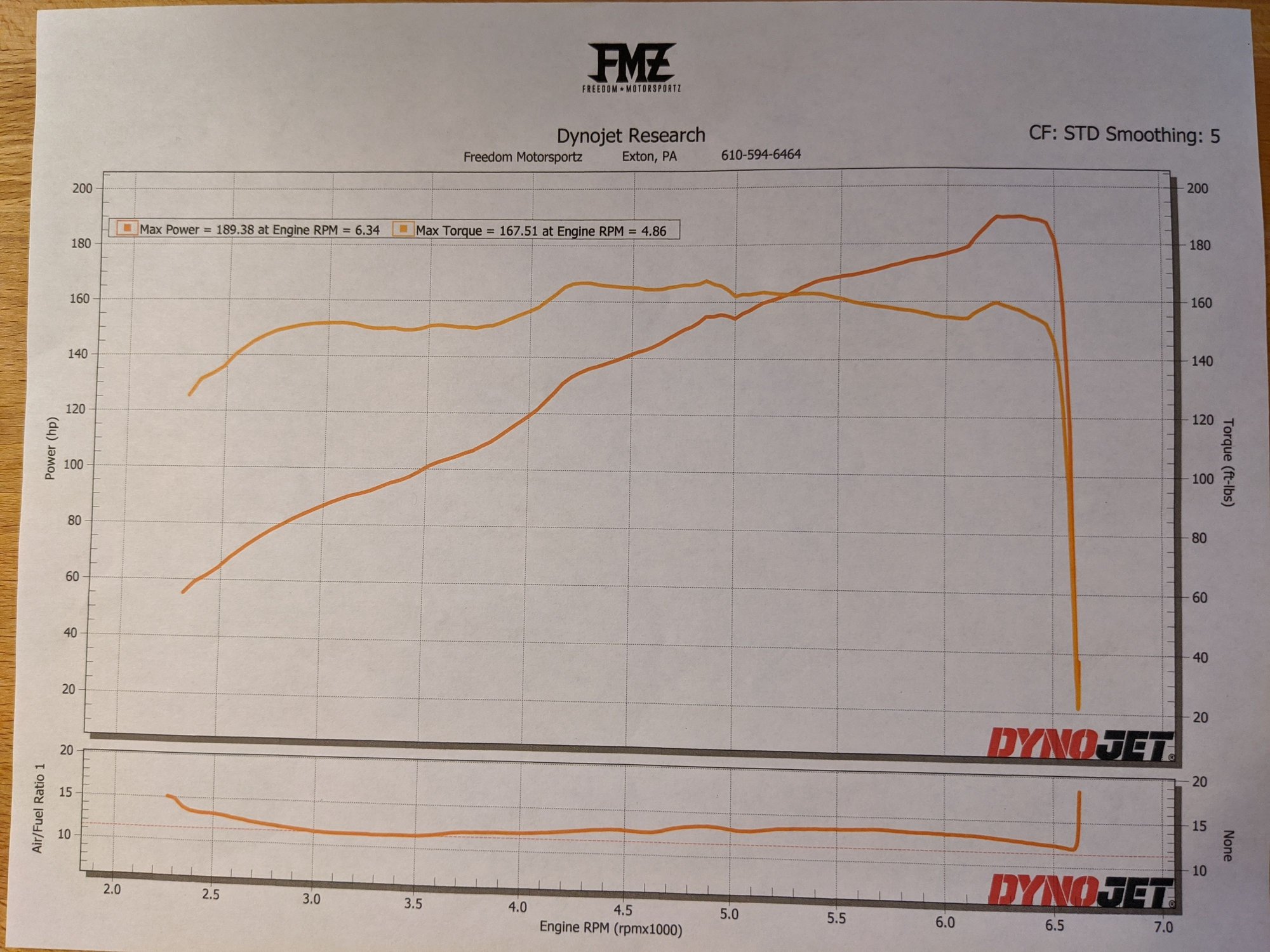

  #70
SalD's Avatar
Joined: Sep 2018
Posts: 37
Likes: 13
From: Pennsylvania
Originally Posted by riyodan_04
Hey man! Whats up? how's your lancer? any improvement on the quarter mile? did you dyno it?
Lancer is good. I haven't made any changes to it in years, except for moving the battery to the trunk. Also haven't taken back to the drag strip since I got it dialed in. It's just been pretty solid sitting at 190whp and 7lbs of boost. I'm not even going to try and turn it up because I don't have boost referenced fuel pressure. If I ever get around to doing that I might try turning it up a few psi.

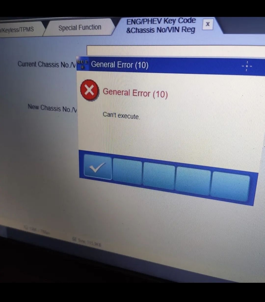

  #73
ciinexc's Avatar
Joined: Jan 2023
Posts: 1
From: Jowo
Error ECU VIN writing
Try to VIN writing on Ralliart ECU with MUT-III and got this error. Any solution for this?
General error
General error
