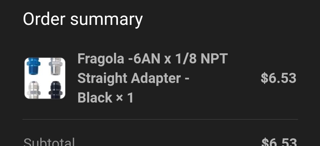

  • Tomei rail adapter for the fpr. Direct bolt on. Needed a 1/8 npt to -6an fitting

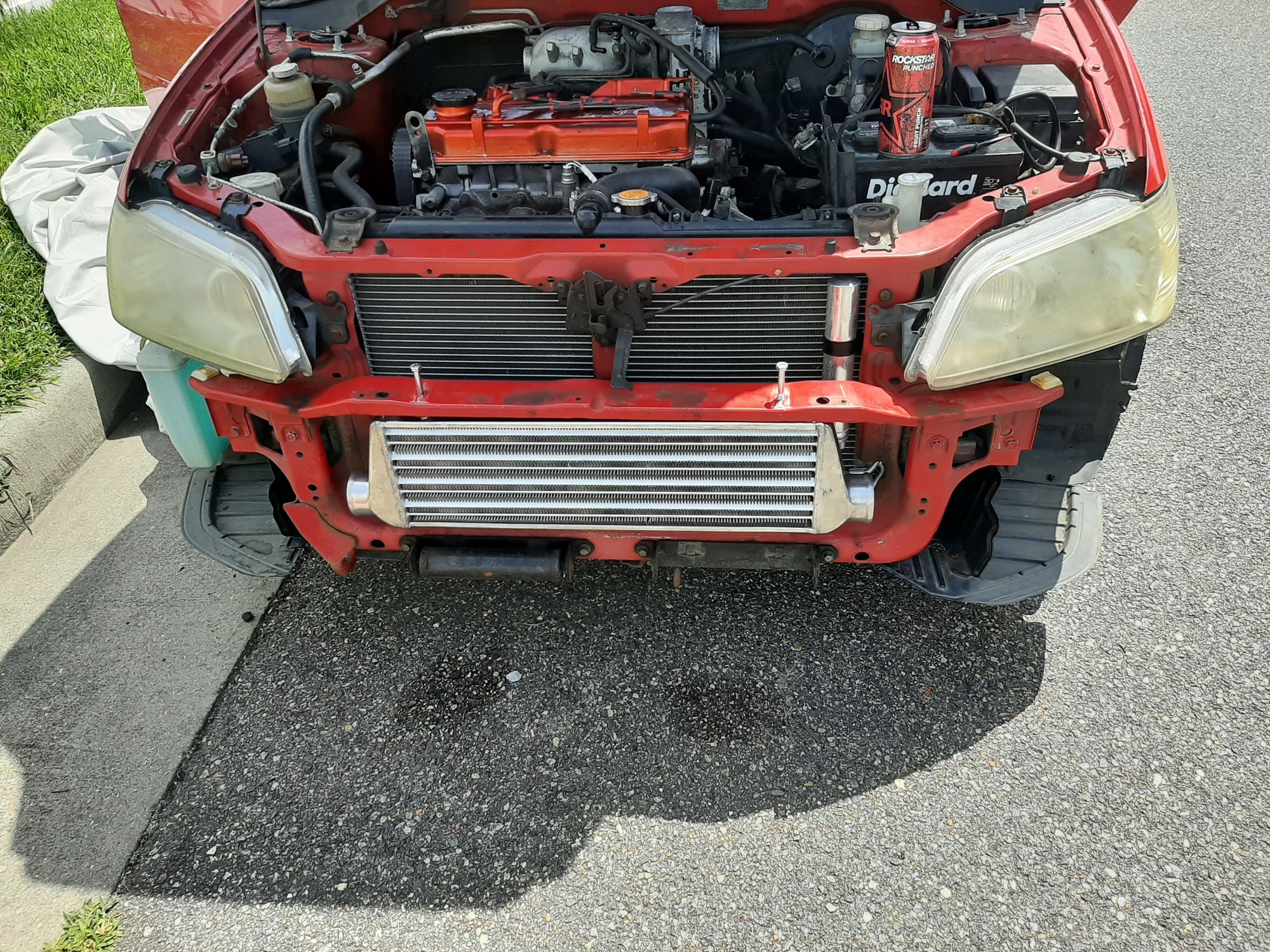

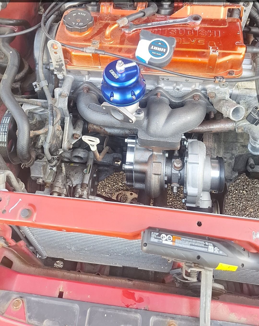

Rough mockup i still need to finish the support brackets for the bottom. I had covid and it absolutely robbed my stamina from me.

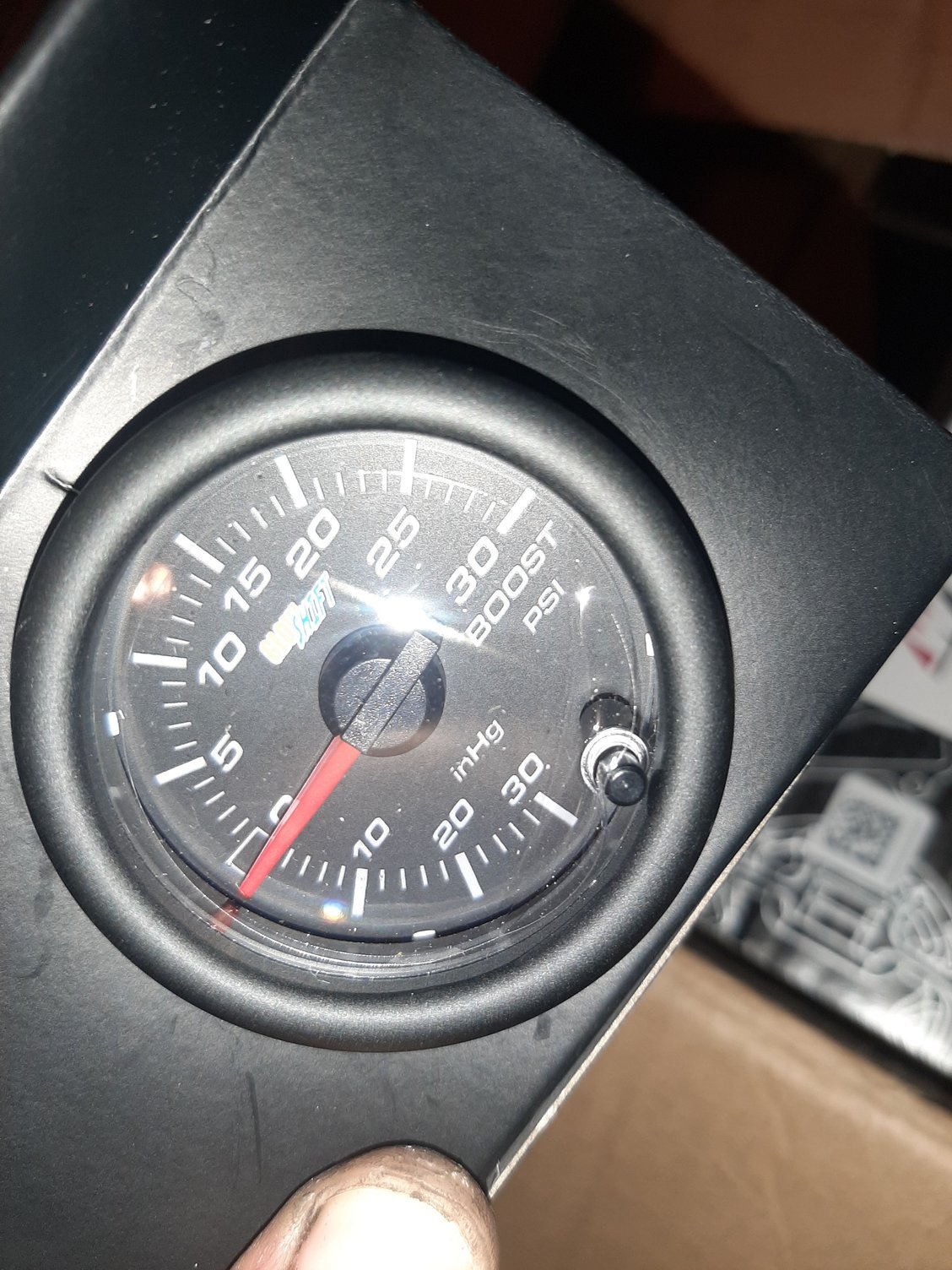

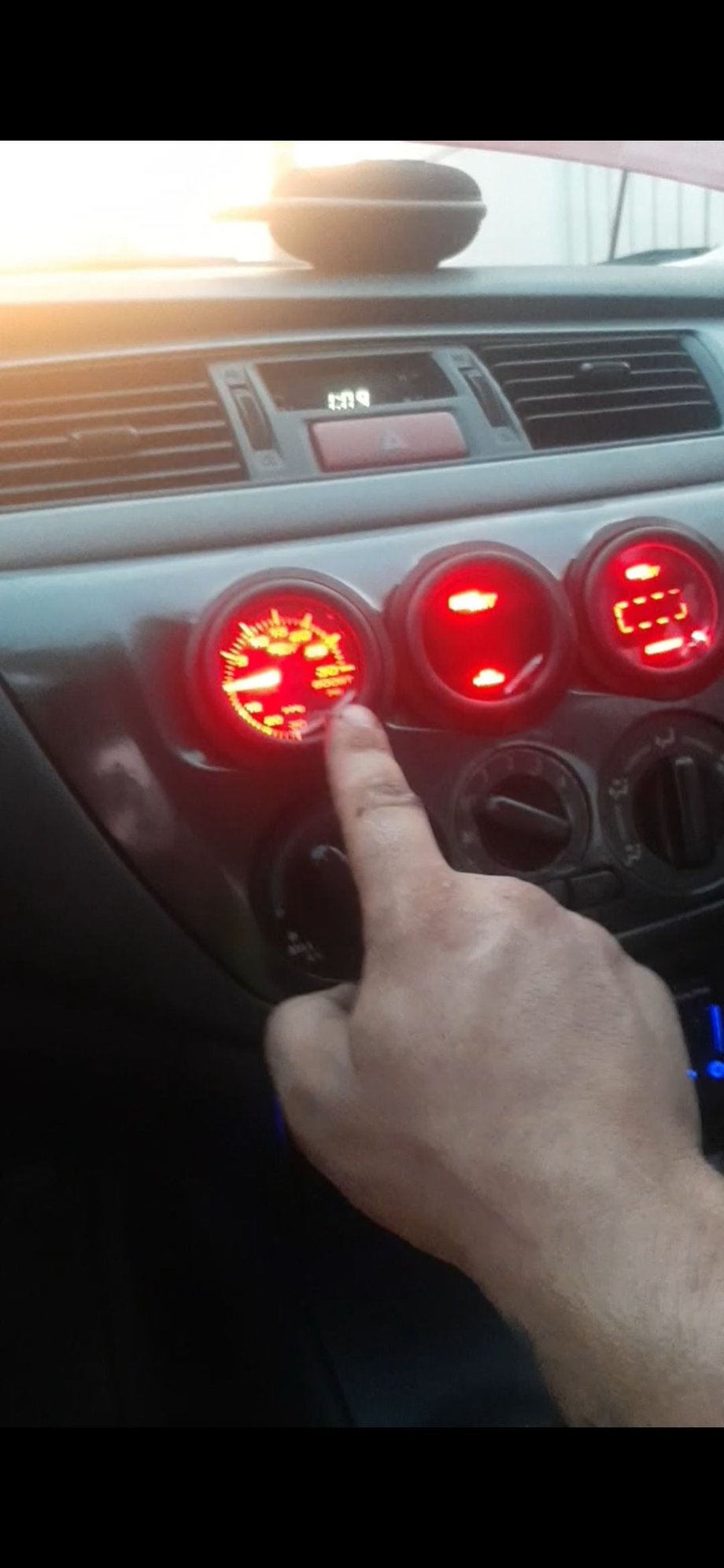

All glowshift gauges installed. None will read right just yet as each connection point is dangling under the hood until the engine is rebuilt. I'll be pulling it within one of the next couple weeks to take to the machine shop.

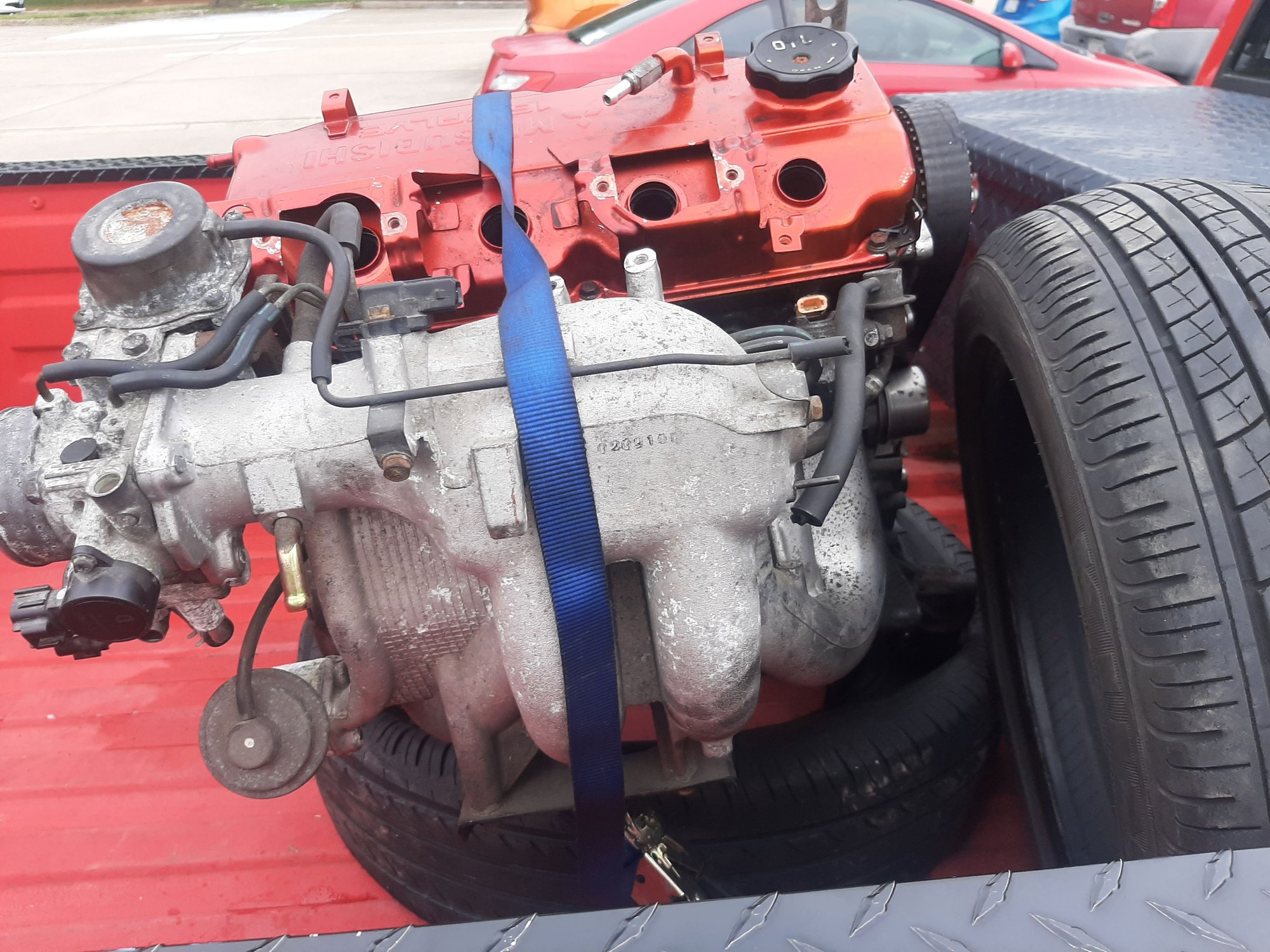

I finally got the engine out. I was waiting for clear weather after getting all the parts i needed. Dropping it off Tuesday at the machine shop to be rebuilt.
