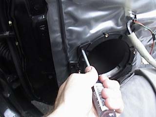

lemme try to find the pic...
it's that round, black, plastic piece that i'm screwing into my door in the pic. it came with my set of speakers. it came with my SPS-170A's. in the rear though, i have the same situation as you. i have a pair of SPS-1629S's. those, DO NOT, i repeat, DO NOT come with a mounting bracket. so, i guess you have 2 options.
1. do what i did, and ghetto rig it; i have my 1629's in my back deck via plastic zip-ties holding them in. i know it's not a great idea, but it holds them in really tight. i put the zip-ties through the holes in the circles around the opening where the speaker goes and into the holes where the screws should go in the speakers.
2. try to go to a local car audio place, maybe even best buy or circuit city. but, you'll probably have better luck at one of the smaller, better dealers and try to get mounting brackets.
hey man...thanx...for the information..^__^.........i will try them out~~~
edit...hey..does these two ways affect the sound of the speakers????

I couldnt find any brackets once so i used small pieces of mechano to adapt the 6.5s to 6 3/4s
