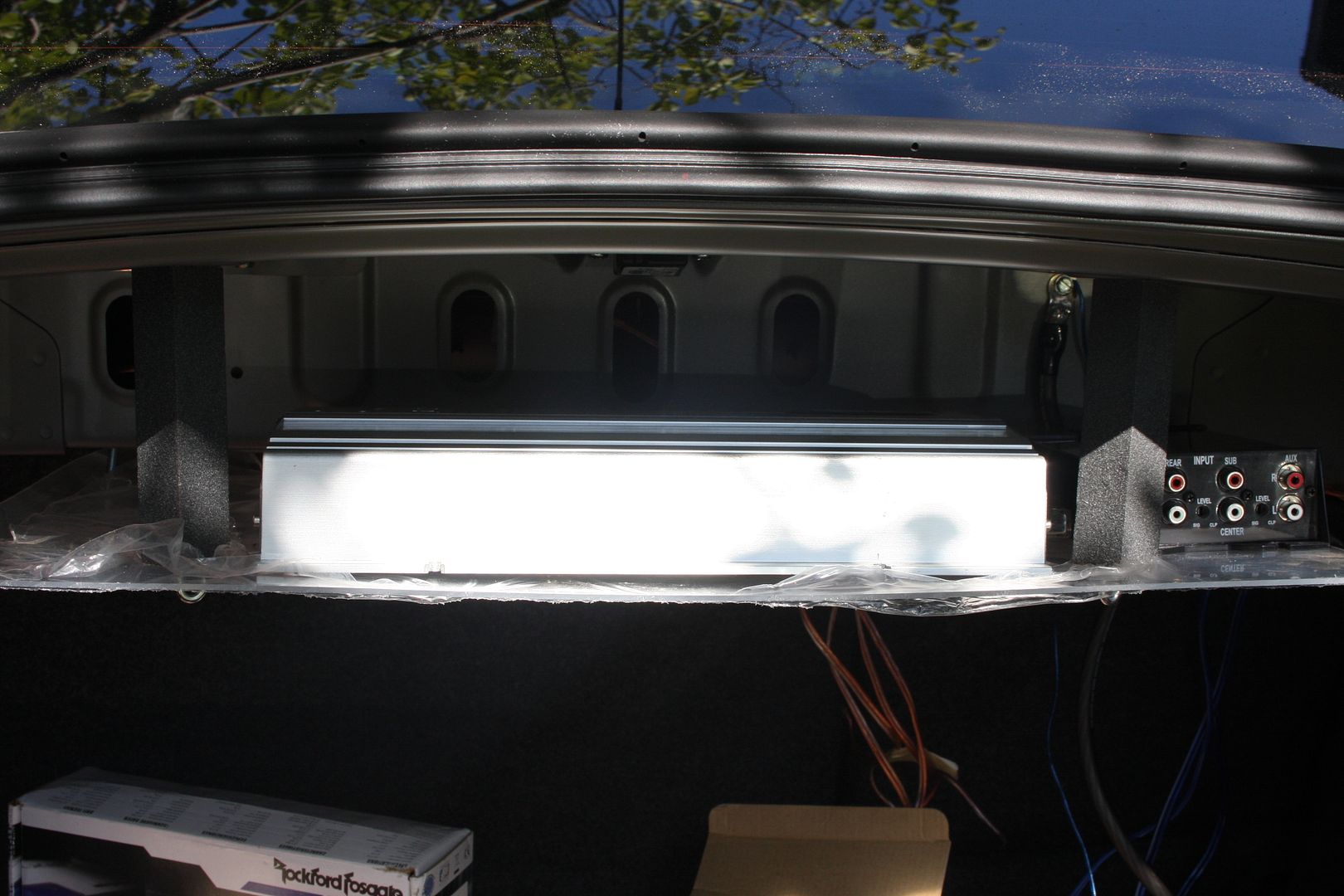

I appreciate the information. What I did was take the line level on the 3sixty and run it from each speakers inputs back. After which I had rca connections via the 3sixty. So 3sixty to the amp and from the amp back to the speakers.
Are there adapters for replacing the amp altogether without getting into a wiring mess? I don't mind this method but would prefer rca's rather than all of these line level crap.
here is the pic of the install currently.
p.s. 3sixty oem integration with the RF amp sucks. The sound is very bland and incorrect.
hrm...not the pic i was looking for...the wires are all hidden now and the 360 is on the left
