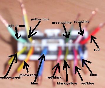

blue , red , red/blue , red/white , green/white , black/yellow , yellow/red , yellow/green , light green , yellow/green. (a picture is shown below.) sorry about the quality!

the picture below is plug that went into the stock tape deck, the only thing is i dont no which 1 is the speaker cables, i really need help thanks!

aw come theere has to be a best buy or circuit city in your are. if not red or yellow are always power of some sort. red can be constant and yello can be the one used to turn of and turned oon when you turn the key. black is gorund orange can be remote for amp or othe device need witht he remote. then that should leave you with speker if anything strip the remaining cable and turn ur hu on bu it on a station and strat conecting cables ans see where the sound come out off. if you dont want to do that the the battery way hook the speakers with a batt they should make sound and there you go.
