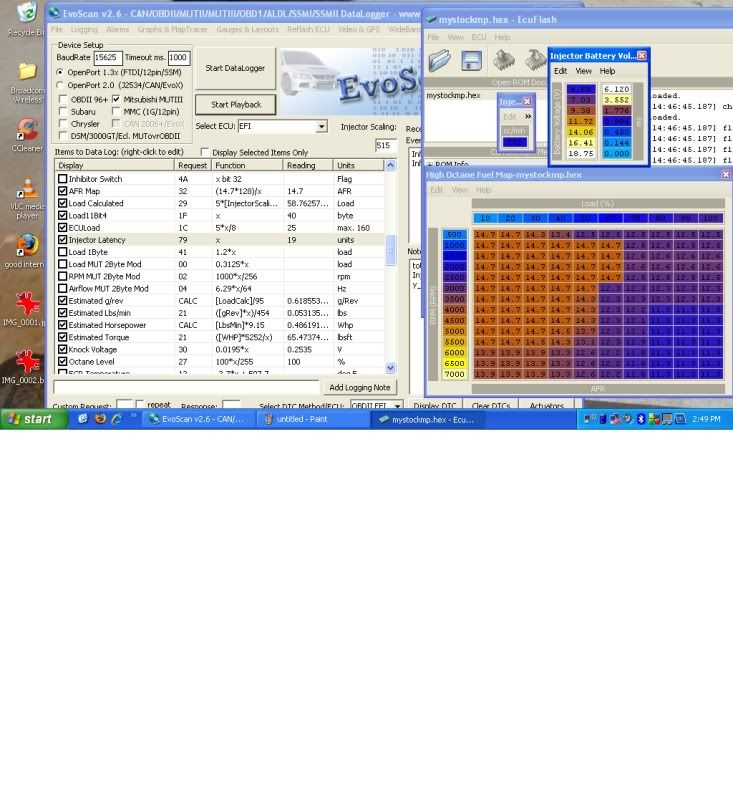

I am swapping out the vortech fmu for 440 injectors. I know i have to change injector scaling and adjust latency to get good idle. I first saved my stock ROM with ecuflash and logged my idle and cruise with evo scan. here is a screen shot does this look ok? should i change the injector scaling on evoscan from 515 to 232 or leave it like it is?

ok i get that but where? in the battery inj volt. window? its in the screen shot. do i increase 14.06? I tried to increase 14.06 to 15.11 and the other values stayed the same.

No. You increase the latencies on the right hand side. Don't change the voltages on the left.
