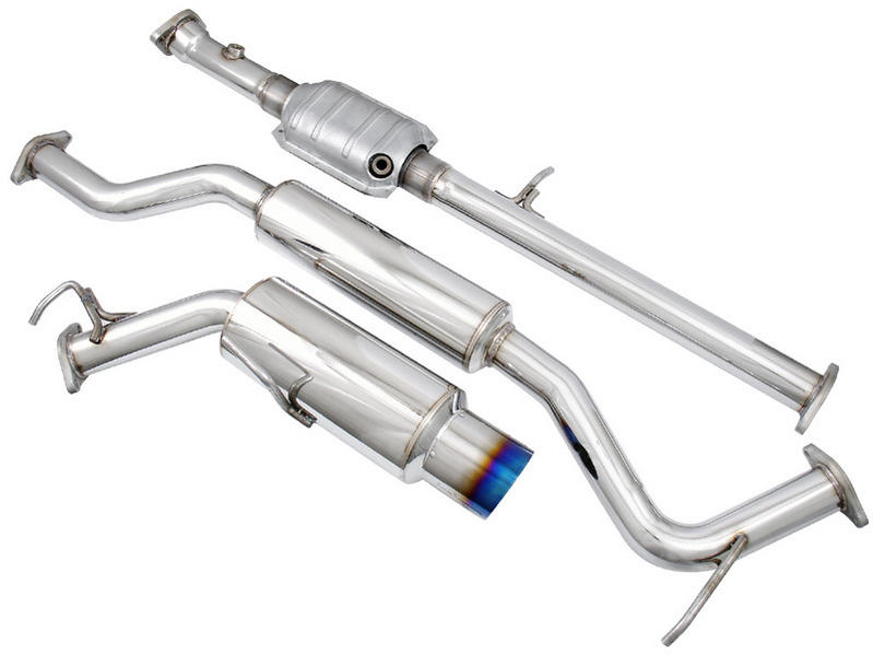

I have the spacer on my ho2s (the hfc o2s). This is the second spacer I purchased. If I remember right, there is no sensor after the cat. There's three o2s:
1. There's a spot on my down pipe but is blocked off with a bolt.
2. One Before the cat
3. In the Cat
*See picture. This is my exhaust...

FED cars have 2 O2s, PZEV cars have one more.
From what I read you should have FED car and 1 free spot for wideband.
In case of FED car, ECU makes comparison between measurements of the O2 sensor before cat and O2 sensor after the cat. By doing that it can decide whether cat is working as expected.
In your case the last O2 sensor is in the end of the cat, spacer should be placed there. You should not put a spacer before cat.

correct, i have a spacer on the ho2s (the sensor that goes into the h.f.c.)

So, that should be fine.. did you asked Injen what spacer should be installed? They usually make tests of their applications, so they should be aware of your problem.
