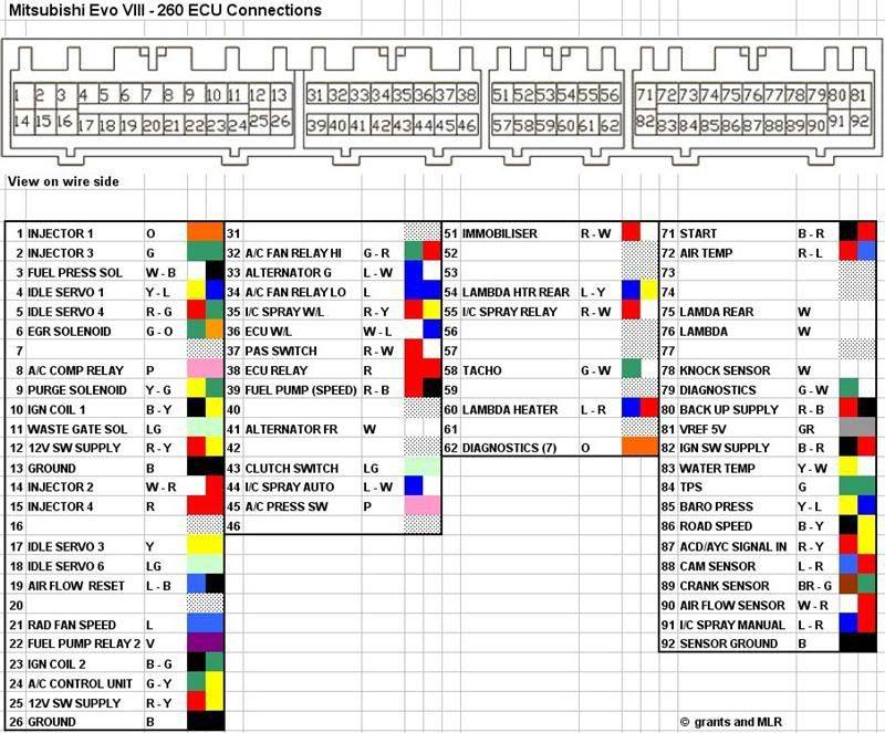

But when I checked pin 79 at my ecu , I found that pin is diagnostics , see this pic
That is not the right pin out this is:
https://www.evolutionm.net/forums/la...r-non-evo.html
At manual pin 73
At auto pin 91
​​​​​​is that correct

At manual pin 73
At auto pin 91
I have no idea I’m not running SD I just saw you had the wrong pin out and tried to help
