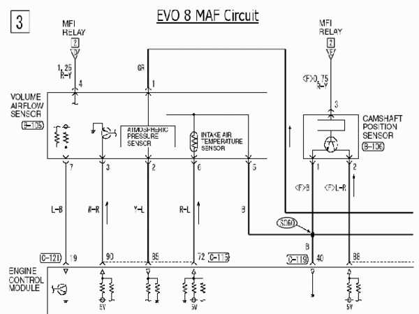

Ok, so I can just splice the output wire from the MAP sensor in to pin 2 on the maf plug im good right?
sensor gets ground and +5v for power which should be ok to split from the IAT sensor correct?
