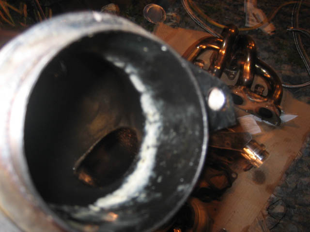

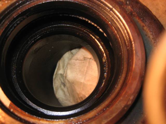

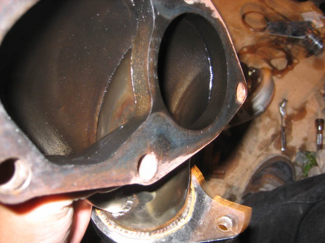

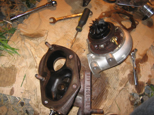

I just finished taking parts apart. (yeah late at night). Here is what I found, just like what Ryan said, my oil return line could be restrictive and he is right and causing to burn it . I took the hodside off from the turbo and it's freakin oily, even the O2 housing.
Here are some pics.
You can easily tell it's very oily. I know it's normal to be oily but that's too much. My solution is go out to tomorrow and buy a another oil pan (silver one) and re-tap it where it will flow better. (I'll take it to the shop this time ) Good thing I work for Mitsubishi/Subaru and will only cost me a bit cheaper. I am positive this is the problem been causing to shoot lots of freakin smoke.
Not trying to be off topic, but should I get 10.5 Hotside later?

^^ Wow, that is an oily mess. Hopefully after getting it cleaned up and a new pan tapped your problem will go away. I would hate to see something major happen to the car right after you turbo it. Good luck
