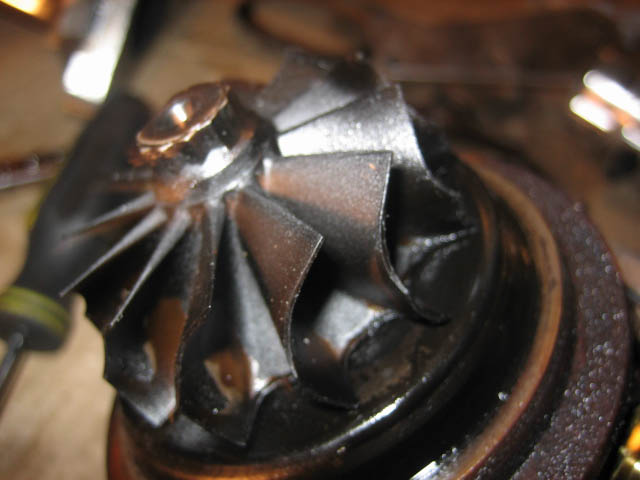

on the shaft that goes through the turbo there is a bushing and some other hardware depending on the type of the turbo that keeps oil from leaking into the exhaust and keeps the oil in the housing where it should be, lubricating everything inside the turbo not outside.

On this part?
I'll take diff. shot later.

I think he means underneith the fan

Damn, that's alot of oil. Actually the exhaust side of the turbo shouldn't get any oil at all. IT should just have carbon build up. Is it a mix of oil and coolant or just oil?

Well, I took it apart, taking the clip ring wasn't that bad and replaced the oil ring. The technician at my work said that the oil is leaking because of the oil return passage, it overflowed and causing to make it leak. Everything look fine, the turbine wheel and the shaft are in perfect condition, and so as the other parts of the turbo, so I assumed there is nothing to worry about which is good.
