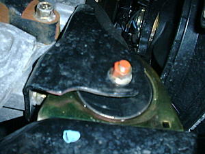

Ok today I almost got both the front and rear mounts installed. I was one bolt and 20mins short on getting the rear done before work. Anyway Im going to tell you all how I went about this because there was a post a ways back that talked about removing the starter and other stuff.
Tools needed:
14mm combination wrench
14mm regular and deep socket
17mm combination wrench
17mm socket
1 extension
Jack
2 jack stands
First get the car in the air so you can get all the way underneath it. The front one is rather simple. The bolts on it are all 14mm. I loosened the one going through the mount first to see if the mount had a load on it and it didnt so it came right out. The mount is bolted to the frame with 2 bolts. The front bolt can be removed with the socket and extension. The rear is a bit tedious, I did it with the combination wrench 1/8 of a turn at a time. It eventually comes out. The new one goes in the same the other comes out.
Next is the fun part. The rear is a real *****, I will finish it in the morning. The bolts on the mount are all 14mm. First I took the bolt out that goes through the mount to see if there was a load on it, and there once again wasnt (I remember someone saying the engine would have to be jacked up for the rear one, but it wasnt the case). Then I took the 3 of the 4 that hold it too the frame off with the combination wrench because there is VERY little clearance. The one on the front right side I used the 14mm socket and U-joint on. Now that the mount itself is free you think your done right? Wrong buffalo breath! There is no way to pull the mount out cuz its huge. Now the bracket that is on the back of the engine/transmission needs to be removed. This is what screwed me over for time. 3 bolts on this and they are REALLY torqued. Use the 18mm wrench or socket, I used both to get this off. I only got 2 of the 3 before I ran out of time. Im telling you ya need to take some ripped fuel or ephedra or something before attempting this cause you need strength. As far as I can tell this is all that is required to get the rear.

Finally done I will be posting a how too later I think here are some pics.

A little preliminary info. The vibration I was *****ing about before was greatly reduced after I got the rear mount on today. There is still a little at my cars lowest idle which is like 600 RPMs (dont ask me why) sometimes. If it is idling normal (750) feels normal. Front bumper vibrates now, gotta fix that. Is there such a thing as drivetrain response? If there is I definitely have it. The *** dyno tells me the car is definitely different. The gears (I have MT) are rather snappy now, whether the gas is on the floor or normal driving. You have no idea how much your car rubbernecks on take off and between gears till you change the mounts. So far so good.
