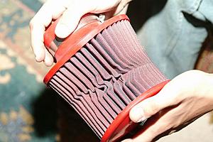

anyone know what the filter size is for a injen cai? mine is BENT IN HALF! What replacment filter should i get?

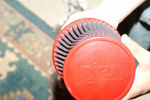

Old Jun 1, 2003 | 03:40 PM
Nero's Avatar
Joined: Oct 2002
Posts: 424
From: Plano Texas

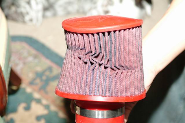

Old Jun 1, 2003 | 03:41 PM
Nero's Avatar
Joined: Oct 2002
Posts: 424
From: Plano Texas

what the hell could have caused this ****?
what filter will fit my CAI piping?

just measure the diameter of the part that connects to the piping, probably 4inch... any filter with that opening will fit easily, just don't get one thats too long or it might not fit back in the original place in the bumper

mine is bent like that...but not as bad...i still use it and nothing wrong

as long as there isn't like a big hole in the filter element and the mesh is in good shape, it shouldn't pose a problem. the size looks like a 3 inch. measure the opening on the filter or the MAs to get a better measurement. or just email injen and ask.
as for a replacement filter. i suggest k&n or accel's kool blue. those are one of the best moderately priced filters out on the market today.

ouch! i have an injen too and mine's a little like that..just a small portion of the outer edge is slightly bent..not the whole thing in half. email injen and they should be able to tell you.
