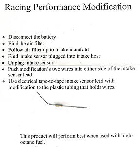

alright so i bought this little modification thing and it was cheap and i want to see if it works. I have a 02 oz rally. i dont know what wire they want me to put this thing on

you got ripped how muh did you pay for that resistor they run about $0.01, and besides it won't work

That just looks like a resistor...
Let me put it this way. If it sounds too good to be true, it most certainly is.
This is a waste of time and money. If you're serious about fixing up your car, check the US LANCER UPGRADE PATH, on the main page.
Keep away from crap like this. Just a friendly warning.

That's a resistor. I can't quite make out the stripes' colors or I'd tell you what resistance. It's worth a dime or so. It may also damage things in your car I'd estimate. It will fool your car into mixing fuel/air improperly by screwing with the signal from the MAS to the ECU.

dude.. i think i know what its trying to do.. its trying to make your computer think that the air going into your engine is colder then it really is.. that is a bad thing.. not good for the engine.. i would stay away from it bro.
