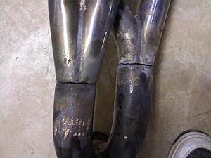

NOOOOOOOOOOOOO BAD!!!!! I had 1/8th in. header wrap on my OBX. While i love this header to death, if you are creating that much heat, you'll destroy your gaskets and maybe even the header. My car has always run pretty hot in the engine bay. So I wrapped my header. Well it took all of a week to burn through the gasket they give you with the header where it connects to the downpipe. I thought oh well, must be cheap. So I got a really good gasket from my exhaust guy. That lasted two weeks. Well I hydrolocked my car about 4 days ago and took the header off and unwrapped it cause the wrap was all covered in oil from the softball sized hole in the front of my block. The header was literally held together by thin strips of what used to be the welds where the four goes to two runners. Well I do like my OBX header and have noticed a performance increase, this dissappointed me. I tried contacting OBX for warranty support. Good luck if something goes wrong with your OBX item. My supplier is trying to gyp me saying its been too long even though OBX puts lifetime warranties on almost everything they make. So I got sick of the politics and its at my exhaust guys shop getting welded back together. I still will order from OBX cause I have a couple of their items on my car but this experience has upset me for sure. Anyways, I loved my header wrap but if your cars running too hot like mine, beware. BTW, my car was in perfect working order and ran hot from the first day I picked it up from the stealership.

No no no. The hole in my block was from sucking water through my intake, bending a rod, and then it snapped and actually left three holes in my block. The header wrap I used which I have verified with my exhaust guy DID IN FACT DESTROY MY HEADER!!! He said header wrap is often used on older vehicles that have MANIFOLDS NOT HEADERS. He said the welds dont hold up on the aftermarket stainless steel headers. And if you use graphite exhaust gaskets which most of them are, the heat will just burn them right up too. The header wrap was made from 1/8in fiberglass. It did work great when it was on, just cant use it cause the exhaust header gets too hot and then bad things happen. OBX has a horrible warranty program too by the way. Im so done dealing with their warranty department.

Just wanted to show you all the damage header wrap can do. This header was not subject to shock that would have cracked these welds. They did in fact crack from intense heat.

Actually OBX tries to say they are made in America but their quality says otherwise. I do like my header. And I have a cam gear and radiator hoses from them that are good quality. But like I said, their warranty program is the worst Ive ever encountered. The header is fully repaired now. Header wrap will destroy most headers my exhaust guy said. The heat given off is too intense. You would be better off heat proofing everything else in the engine bay.
