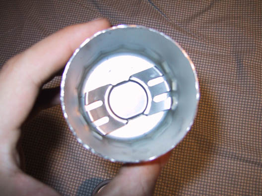

Here goes. Too lazy to diagram, but you can see how differently designed the K&N is. The combination of it and the Mobil 1 actually smoothed out my idle a bit, allowed quicker warmup and also seems to have helped with my decel stalling problem at bit as well. Go figgur. Seems part of my problem was mechanical after all (though only partially because the realy problem still clearly lies in the EMS).
BTW, too lazy to diagram right now and you can see the parts on the K&N site so here's just my analysis. The construction's actually really cool. BTW, part number is HP-1010 for anyone interested.
Before the ****storm that is my Dremel:

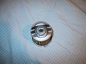

Here's a pic of the leaf spring used to keep the element in place so that oil can flow freely around (and then through) it.

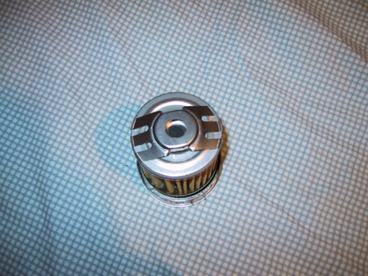

A pic of the filter element with the leaf set on top. The leaf is free floating once you open the can so it's really just placed there, not attached to anything.
