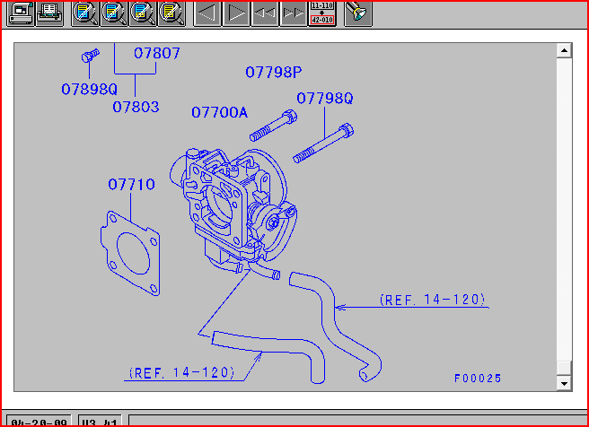

Throttle body gaskets are not meant to be re-used on the 4G9x engines. Also make sure that you install the gasket the right way. It has to be oriented a specific way. See the diagram.
i installed it the right way.. i guess i just need a new gasket..
