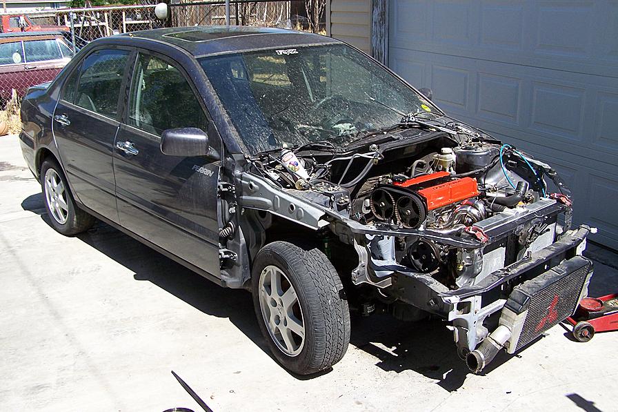

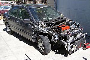

EVO IV 4G63T+06 Lancer=BA NEW VIDEO

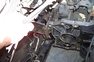

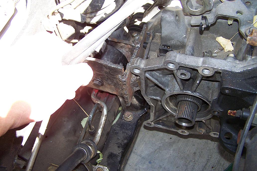

Attached Thumbnails The lution By 3rd KREW Performance-166.jpg   The lution By 3rd KREW Performance-169.jpg   The lution By 3rd KREW Performance-170.jpg

looking good what all did you have to do to get that shoehorned in there, the bodies are pretty dam close to being the same... Make a write up...

I had to build a rear tranny mount and welded a evo viii engine mount on the frame.

Heres some updates i had to move the front transmission mount forward and up about an inch and redo the rear one for the transfer cas to clear the sub frame.
