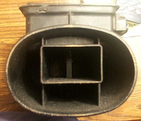

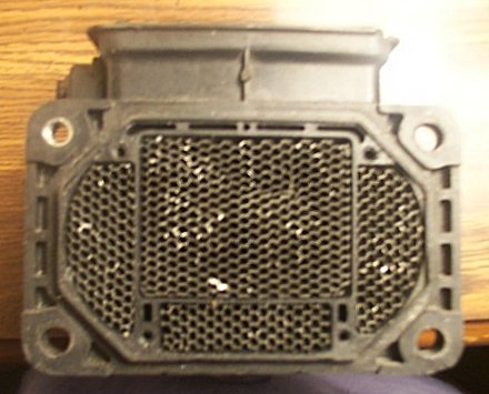

Sorry about the pics not being clear . . . it was at night over the house of a DSM'er and using his digi camera which also took the pic of my engine before the recent mods.
Here's the 2g MAS comparing them to the 97 and below mirages w/ the 1.8L (from the above mentioned link).

Backside of the MAS . . . it's huge!!!!!
