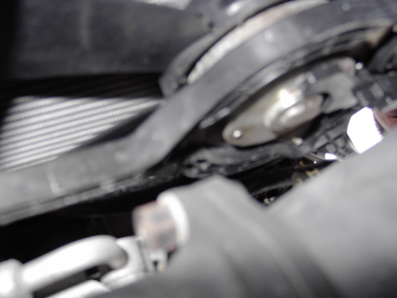

As you can see (if you can) the nut im using is a relatively longer nut. It wraps the whole bolt till the tip, also put the lock washers, would this help? this was all impact wrenched in so i guess their pretty tight.

using and impact wrench to tighten things is a BAD idea about 95% of the time... strips bolts too easily.. especially ones this small.. keep in mind an impact wrench goes to about 300ft-lbs of torque!!! I torqued mine probably to around 40 ft-lbs.
The lock washers should do the trick... You'll have to keep an eye on things...

Torque wrench
Man you are having issues! LOL..
hope it works out ok/doesn't cost much. If it's the weld.. take it to the place that did it and make them do it for free. It would be their fault.

Guess what happened to me
I could hear an exhaust leak.. I noticed it particularily after going through a toll (those nice concrete walls really help you hear your exhaust ) and tried to figure out where it was.
Well it sounded like it was coming from the flex joint (great eh?) so I took it to CarX to have them peak at it since they give nice free estimates and will bring you in to look at your car when it is up. Well wasn't leaking at the flex (thankfully) turned out it was leaking at the mating between the DP and the header. The tech said it was the gasket.. and I mentall figured that couldn't be possible since the gasket is solid copper.. and that doesn't really just fall apart.. can't physically...
So to make a long story short... all 3 of my bolts were a bit loose, not by much, but just a hair. So I tightened those bad boys down again, and now it's all good again. So I guess the story is put on some lock washers, or keep checking and listening for issues at those bolts! Good thing the "lock nuts" really work eh?

same problem with mine, but eversince i put bigger nuts and lock washers, havent had any problems since.
