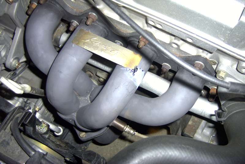

Here are some pics of my setup to help you guys out
1)

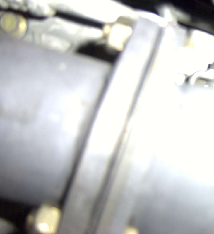

Sorry this one is a bit blurry but give you an idea of the nuts on my header....

A view of the header as a whole...

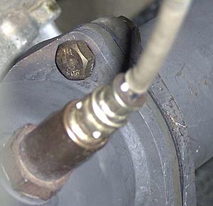

slightly different angle/view of the nut and o2 point.

my o2 sensor is a little lower down than yours - is that ok? ill try and take some pics when i open my hood again either later tonight if i get this homework done, or tomorrow after school if its still a little nice out like today

yep lower is ok.. as long as it is only like 6 inches or so.. if you get down to the bend in the dp then you are starting to get too cold basically.. which can cause problems.. but should be fine.
yes that nut seem to be the same size that ive used but fell off after some good runs on the expressway. Now i got bigger nuts with lock washers, I hope it'll solve the problem. Ill go back on the expressway and take it to a 80 Miles test drive this weekend, I hope the whole headers will still be intact when im done

I've got those bad boys torqued down awfully awfully tight.. more or less as tight as I could possibly get them using a 3/8" ratchet with a foot extension on it.. with someone holding the top for me.. But everything was tight... and it sees plenty of rough roads and hard shifts...
