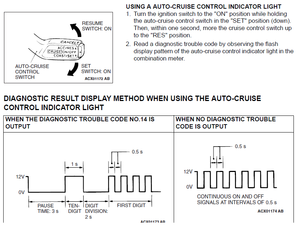

Ok I bought my 02 lancer oz rally about a month ago and one day I was driving home from work and decided just to try the cruise control out just to see if it works. It did great! The next day I got in and started it and the cruise control light was on and now every time I start the car it's on. Doesn't affect anything and it still works when I want. The light just bothers me haha
Any help??????

Here's a nifty page for ya.... What they don't tell you is that you have to click the button on the side of the lever to the on position first. Took me 15 minutes to figure that one out and get the right combo. Let me know what number it gave ya (only possibilities are 11-17)
