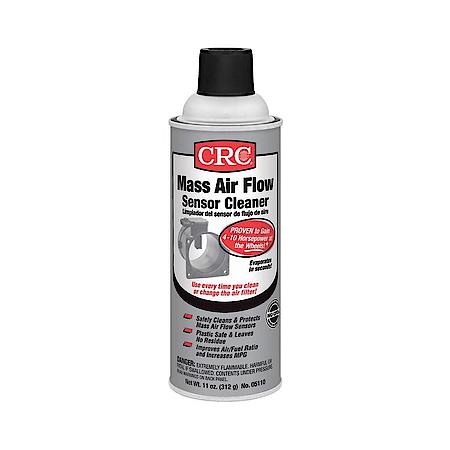

Mass air flow sensor cleaner
Is this safe to use on a 2010 mitsubishi lancer ES?
Attached Thumbnails Mass air flow sensor cleaner-mass-air-flow-sensor-cleaner.jpg

Generally yes, MAF cleaner can be used on any MAF sensor from any car. I would recommend looking up a youtube video on how its done though, the sensor is very fragile and expensive to replace. Some people recommend spraying it onto a Q-tip and "very gently" cleaning the sensor. Others suggest spraying onto the sensor and letting it air dry.
But anyways, the answer is yes, it is safe.
