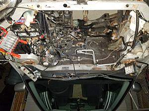

I was able to pull motor with automatic trans still in car. Loosened the trans mounts and it was a tight squeeze but managed. And I did it myself with no help. I did not load pics upside down that's the way the site took them wtf.
