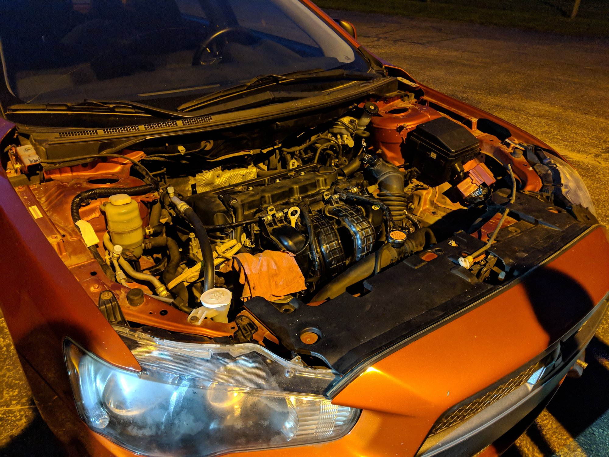

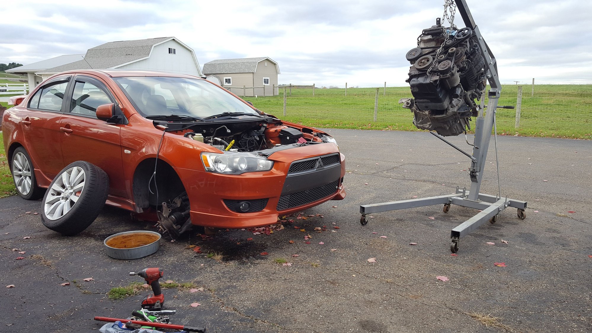

Undergoing the transplant in the back yard lol.
