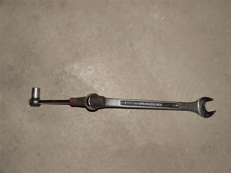

You can actually get the mount off the crossmember from the top. You need a 3/8" drive 14mm socket and a 6" extension. I just went out and confirmed that this works on my car.
The one going through the middle? Brute force if its stuck. Muscle up dude and use leverage to your advantage.
Look at these pictures for that middle bolt.
Socket on the left. Open end wrench on the right. The open end wrench is positioned so that the crossmember holds it in place when you turn the socket counterclockwise.
The socket wrench is set up with an extra elbow. I use this trick constantly. It multiplies the force BIG TIME. You will have to use this contraption from underneath because of its length.
