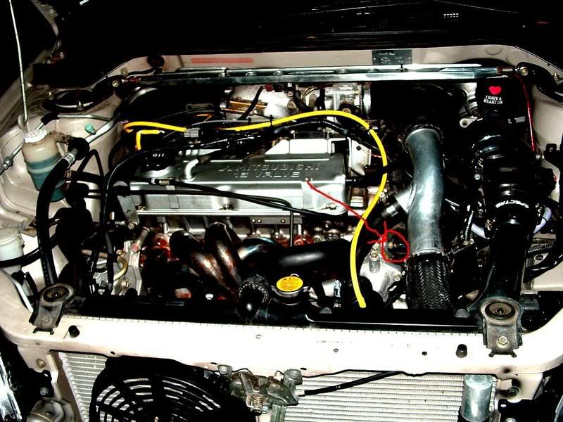

check your temp sender connection. its on the side of the engine near the radiator hose. should be a thin wire with plastic connector. You may have knocked it loose.

I had a look at the car this morning and accidentally get it fixed when I spotted there's a loose wire. The engine light was still on, but then I disconnect the negative battery and reset the comp, now the engine light is off. Thanks everyone for help!
