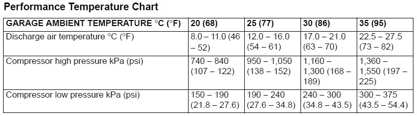

recharging details
I have lancer 2007 and i need to know if any one can help me where can i find the charging details for the ac i need to know how much weight I'll charge

this? it's all I could find in 5 minutes...
